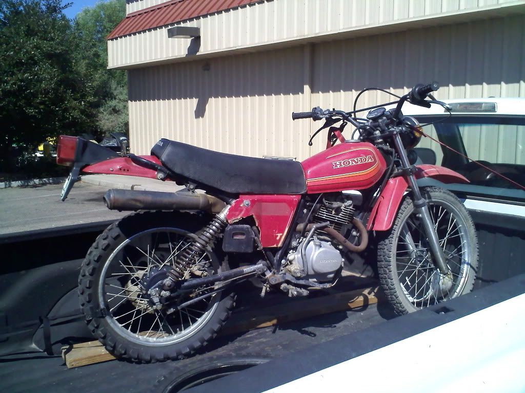

Update. Here is the bike in the truck this morning. I stopped over at TFOG Wheelsports and spoke with Mr. TFOG himself. Turns out he was so close, that I could have easily pushed the bike to his shop. We've got some parts ordered. The clutch handle, shift lever, and a battery. He's got a nice shop, and for sure is NOT just a back yard mechanic. I took this picture at another place though.

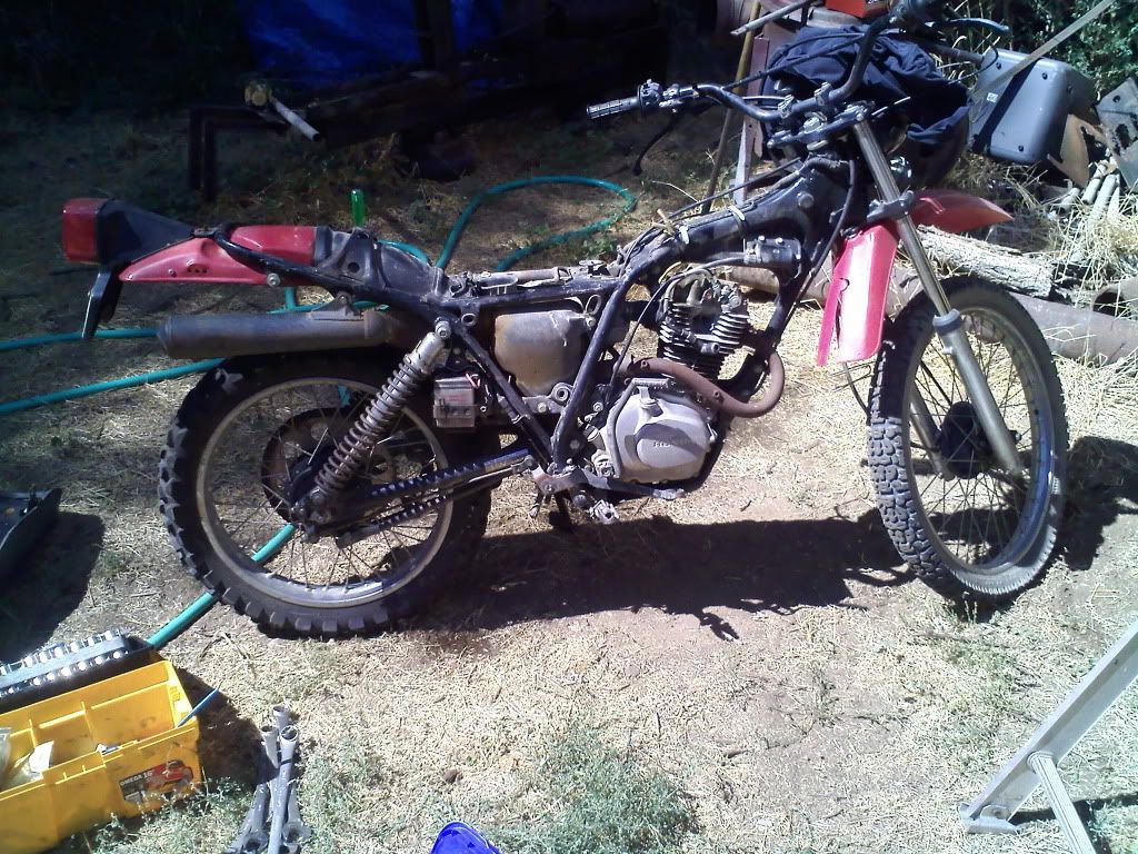

Here is the bike with the seat, gas tank, and side covers off. My grandpa got a good laugh at me when he found out that the valve lash on each side was about 1/8". No wonder it ran like crap when I put the motor back together from a 5 gallon bucket 10 years ago! I didn't get a hold of TFOG until the end of the day to find out that they should be set at .002 (intake) and .004 (exhaust), so in the mean time, they are both set at .006. I'll fix the valve lash on Saturday.

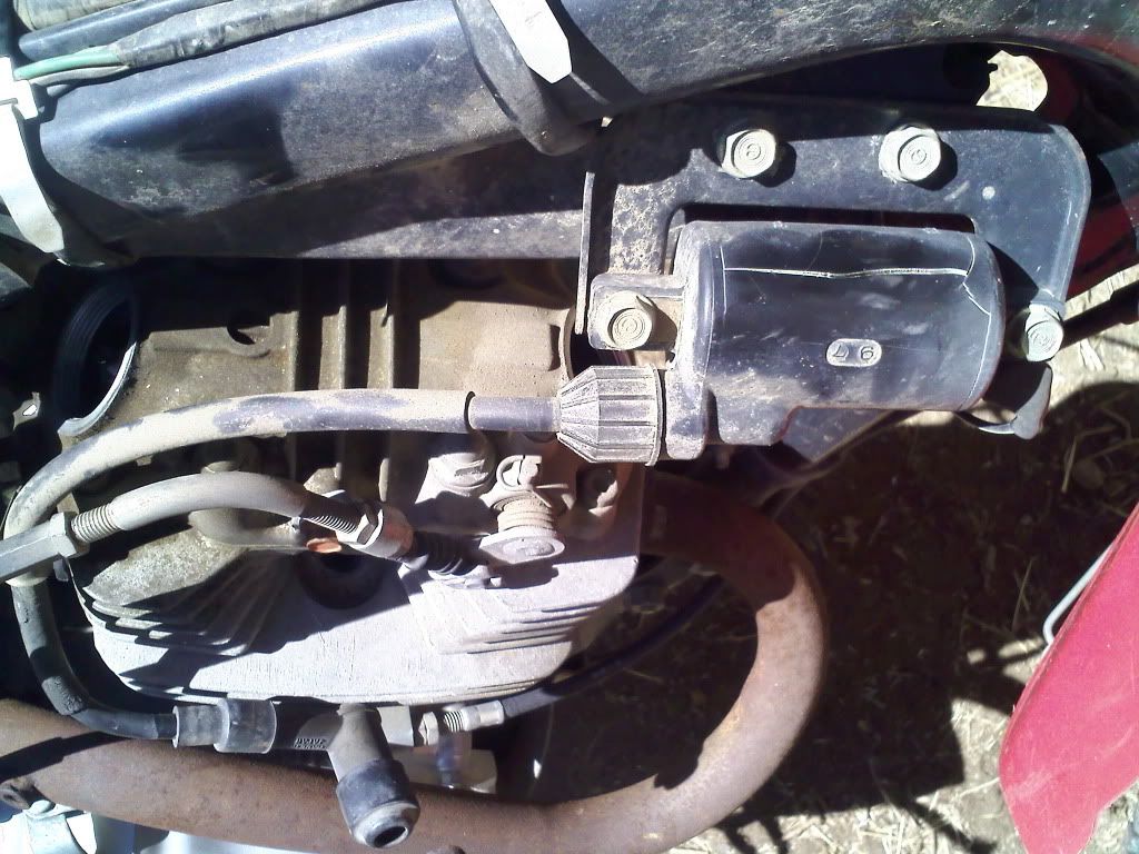

Saw that the coil cover is also cracked, so I'll have to order another one of those as well.

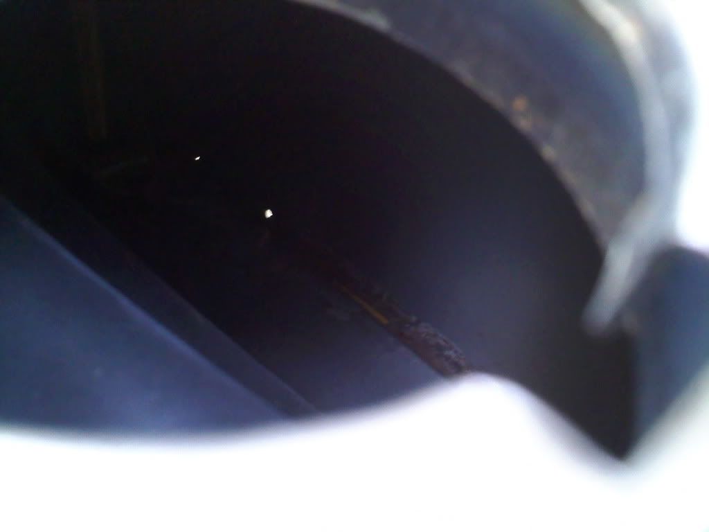

Next we checked the gas tank. There was for sure some rusty chunks rattling around in the tank. So, we took some fine sand and put it in the tank and shook it around (several times) to break the rest of the crap loose. Considering there is a wall around the filler hole, I was surprised at how easy it was to get all the sand out. A vacuum with a small hose attachment and a small flashlight easily took care of the rest of the sand. That was about when I found the holes in the tank though.
You can see the sun shining in through the small holes on this shot of the inside of the tank.

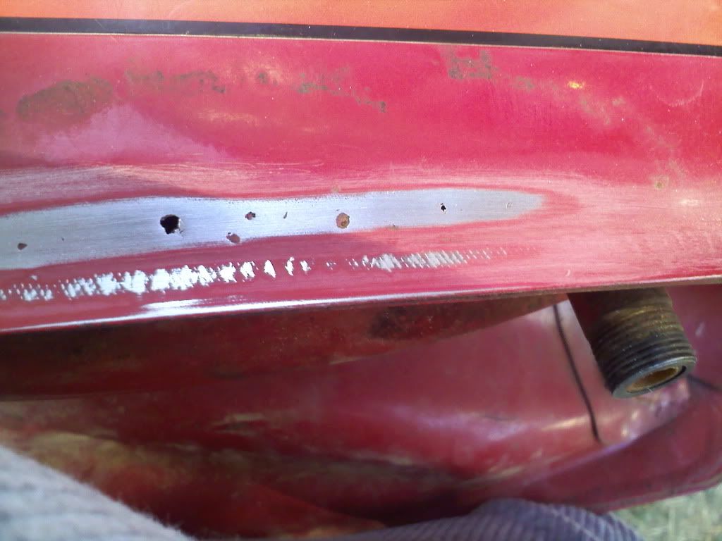

And here they are after I sanded down the paint.

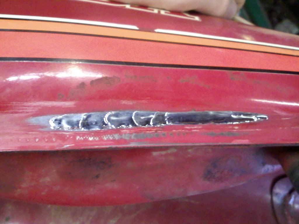

Next we soldered up the holes on the outside.

Hey Stu, will solder actually hold on that tank over the long term (considering the abuse a dirt bike takes)?
I have no idea. I just did what my grandpa told me to do. I have a feeling that the Red Kote on the inside, which is supposed to work on its own, combined with the solder will be fine. I doubt this dirt bike will ever see all that much hard use. I'll probably end up parking it up in the Pawnee Grasslands and only riding it whenever I can get up there to do so.
