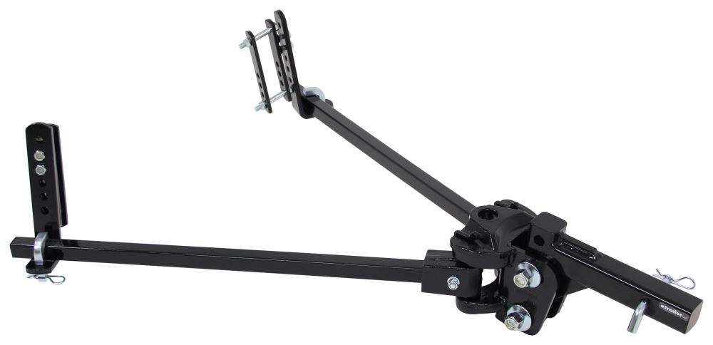

I do have a Fastway 2-point WD hitch I used to pull my boat behind my old fifth wheel, but I'd need to take the brackets off the boat trailer and it would need to be setup properly on yours.
The WD hitch head should just be a head attached to a receiver drop hitch that slides into the receiver.
Do you have any pics or details of what you have?
Here's a fastway for reference. Similar to an Equal-i-zer 4-point. The fastway bars just pop into the head, the EQ 4-point bars are held in with bolts that apply pressure to help more with sway control. Either one also applies enough pressure at the bar to bracket joint to help reduce some sway, but the 2-point isn't significant.
