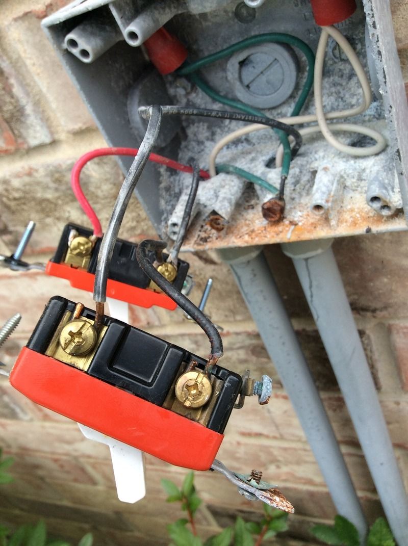

So I'm in the process of troubleshooting my pool light and I'm stumped. I just installed a new switch and still have the same issue.
Switch on left is the pool light, right is spa. Spa is working fine. Meter is showing 85 volts on the pool switch, 121 on the spa switch.
http://i778.photobucket.com/albums/y...image.jpg4.jpg
