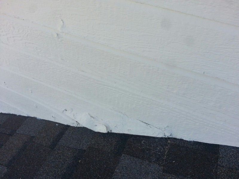

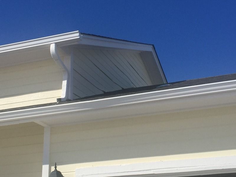

I need to know if the cost to replacere this siding will cost more than $2000.
The seller has agree to lower the price in the inspection objection. And I don't want to accept now, to later find out its a $10,000 job.

Can't tell exactly how much or the product (hardboard or cement board) that needs replaced but tear out, disposal, install, caulk and paint...
I don't see it being a $2000 job but nothing near $10,000.

Do you want it replaced with the same thing? The issue isn't the siding it's the install. They should have left a gap at the roof line and make sure they properly flashed it. The large end they didn't hang it with an expansion gap

South side has far more sun exposure and generally wears faster than the other elevations. North side should be in the best condition.
hardi board or similar product. (multiple similar items available) nice stuff, but is a bit pricey. Wears great though. 10 years here and not an issue.
Yea that wind kicks the snow up on that side, that's what causes the buckling. So I've been told

The big thing I see with that kind of siding is that moisture gets in around the nails, then sits at the bottom of each lap and swells.
What you showed photos of is an installation issue, and not an issue with the product, or the local conditions.
