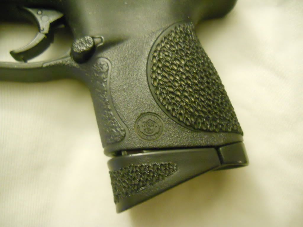

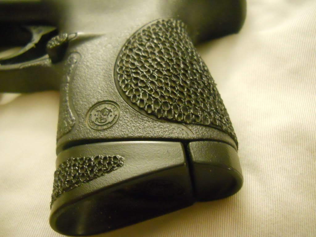

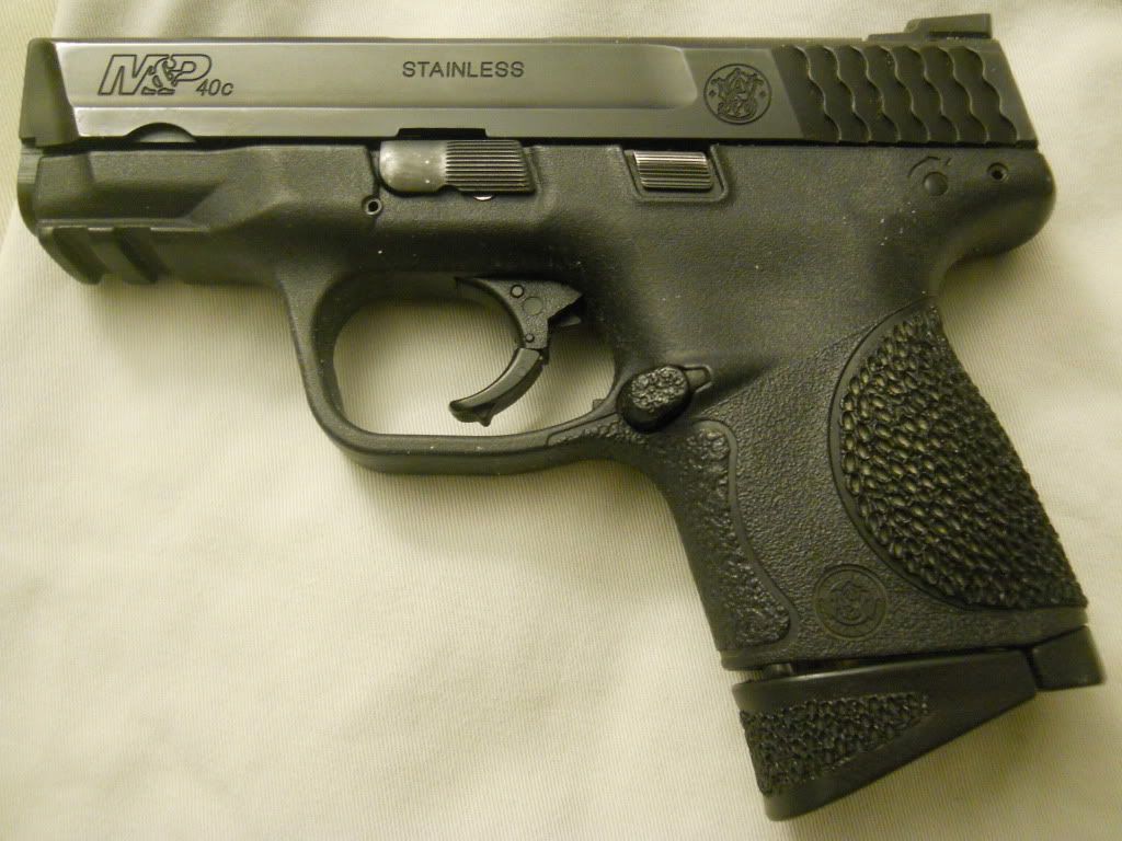

I'll have to post the pictures of my M&P on here some time. I'll have to go steal, I mean borrow the camera.

I'll post the pics as soon as he's done with my M&P. [Beer]
