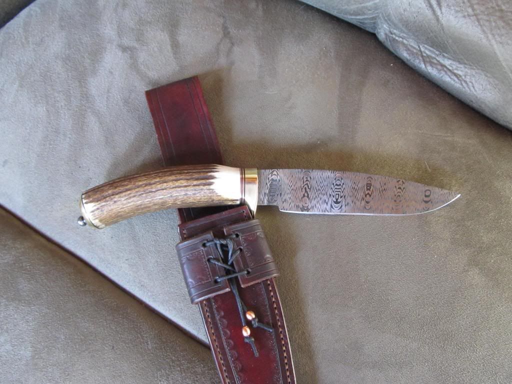

This is a short how I built the damascus NRA hunter I'll do it in stages and try to explain as best as I can, please feel free to ask any ? you have.

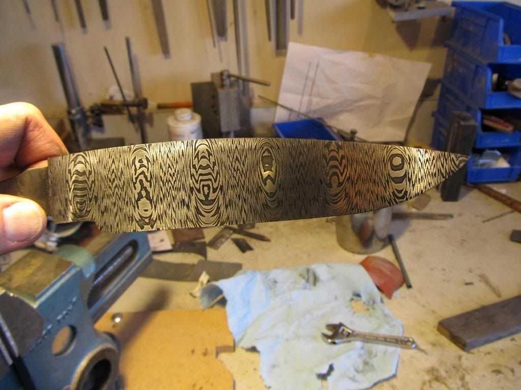

When it's all done and annealed I grind off the scale and then I have to get the pattern on the sides instead of the ends where it is at now. There are a lot of way to do that but here I'm doing an accordion cut. First I drill the hole that will be the bottom of the accordion so that it is rounded and will flatten out without tearing. Then I'm going to cut out the triangles that are scratched out on the billet
http://i1307.photobucket.com/albums/...ps8838a61d.jpg
http://i1307.photobucket.com/albums/...ps23579663.jpg
that leaves me with an accordion shaped billet that is about 3/8" thick the pattern is on the ends of the triangles that I cut out. When I forge this flat it will bring the pattern the the face of the blade blank. I use a 1/2" round bar to slowly flatten the billet out if you are not careful the bottoms will tear because there is a lot of stress placed there.
http://i1307.photobucket.com/albums/...ps25634c57.jpg
then I forge that into a knife shape that I want.
