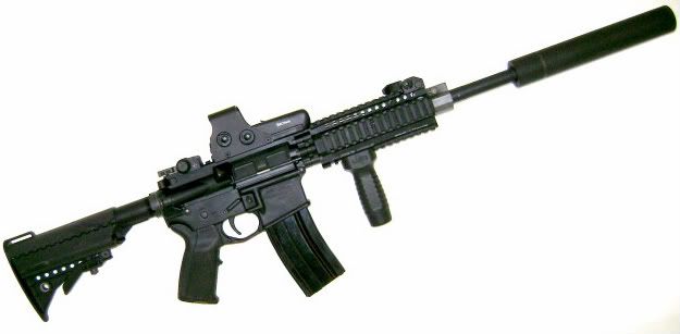

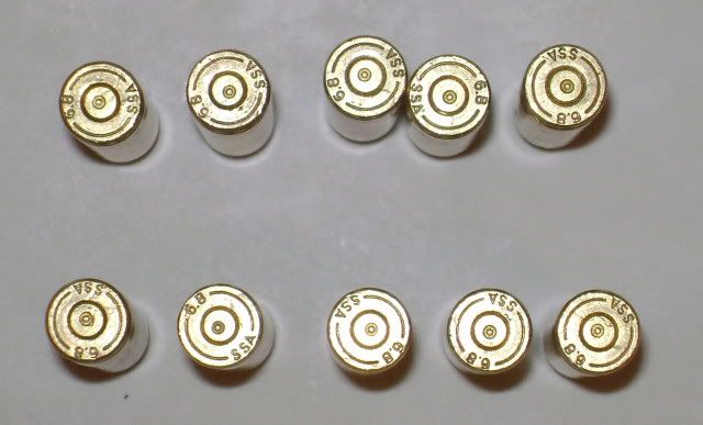

    I just thought I would post here on my first outing w/my Cardinal 12" because of the Chrome issues. I ordered this from them in mid-October (long after the chrome issues came to light), but haven't gotten a chance to get it out to the range. I was shooting prone w/bipod, just trying to get my Eotech sighted in and make sure that the barrel would handle the hotter loads. I was getting 5 shot groups touching at 100 yrds and that's pretty damn good for me shooting prone w/a bipod. I'm not a great marksman by any means, so I was very happy w/that. I was having short stroking issues at first, but then realized I had my gas block set on surpressed. After switching it full, I had no FTF or FTE's. Below are 10 rounds fired of the SSA 115 OTM combat loads. A couple look like they barely have a little ejector swipe on the rim, but nothing stands out and I have no flattened or punctured primers.
    The 115 OTM Combat loads:
    So it looks like I have no issues w/the chroming causing high pressure from the lack of damage to the cases and primers.
    The SBR:
    I must say that after the 200 rounds I put thru it today that I am very happy w/my build. Chalk up one more Cardinal barrel w/no issues. I'm hoping to get to a actual range and bench it to check for accuracy and make sure everything is sighted in correctly.
