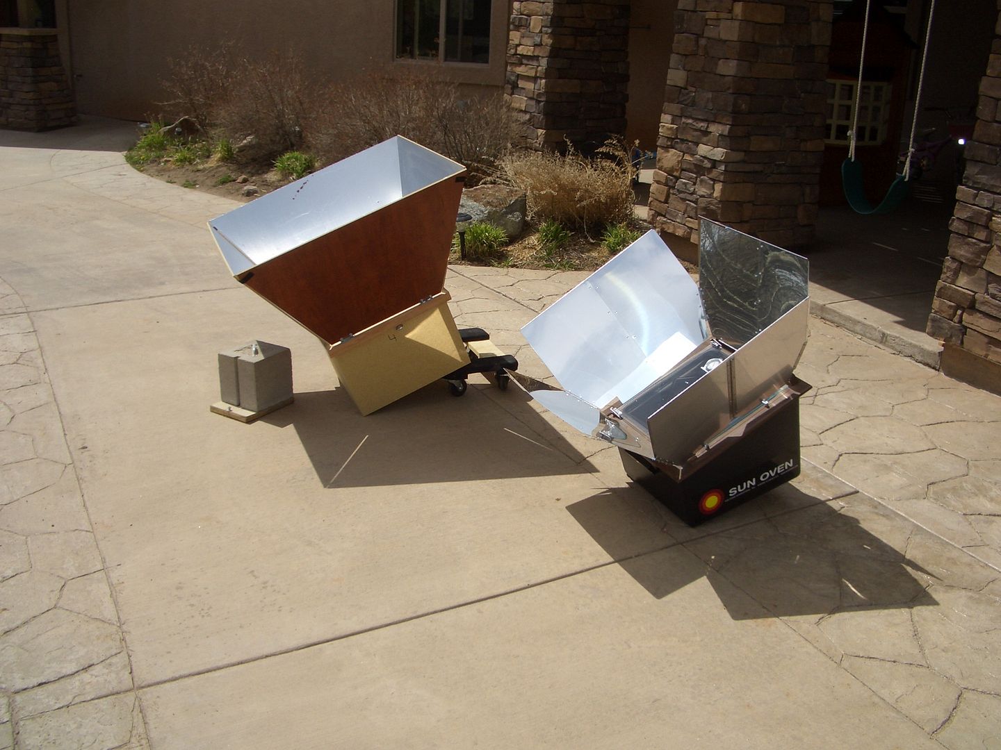

    I've been wanting to build a solar oven since I first discovered the concept. I finally got it done a few weeks ago. I also had an opportunity to borrow a genuine Sun Oven brand solar oven. After getting mine built, I set them up side by side and did a few days of comparative testing.

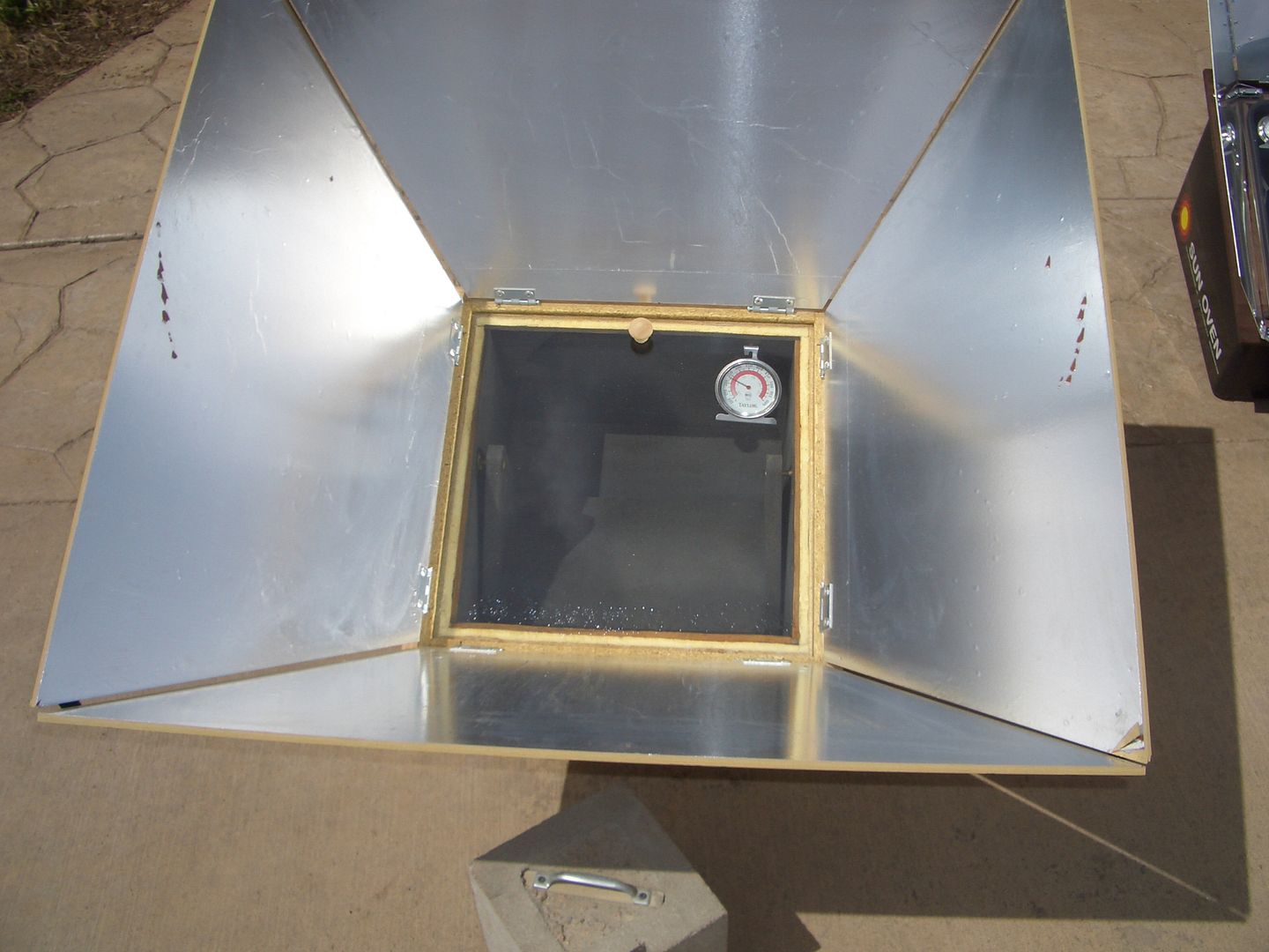

    My design goal was to come up with a design that was inexpensive enough that I could make a half dozen or so for the cost of a single Sun Oven, and do the majority of the cutting on my CNC. Of course, it had to work, too. My preliminary design is shown. It uses 3/4" particle board for the outer box. Next is 1/2" rigid foam insulation with foil on both sides. Finally, I lined the inside with 1/4" MDF painted black. The reflectors are 1/4" melamine with aluminum foil applied with spray adhesive. The cover is 1/4" glass. The "swing" on the inside is also 3/4" particle board. The reflectors are attached to the oven box with hinges, and velcro is used to hold them together at the top.

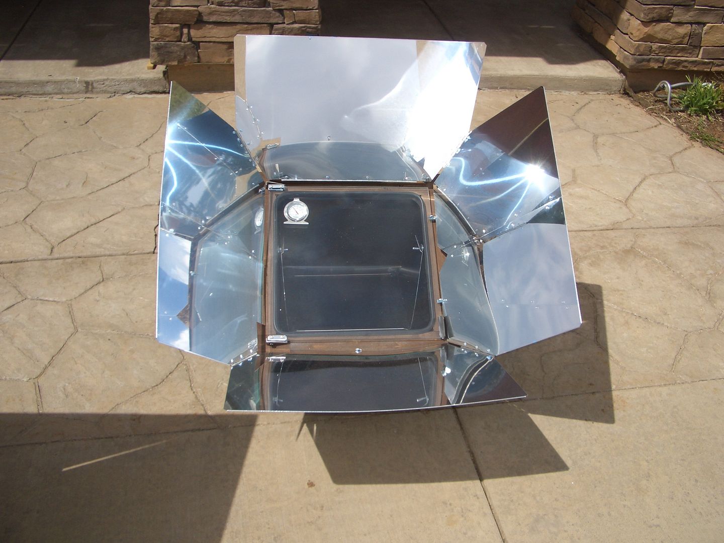

    In side by side testing, the Sun Oven heated up much faster. Amazingly fast, in fact. Leave that thing in the sun for 20 minutes and it gets right to 325°-350°F. Pretty impressive. By comparison, my oven took twice as long to heat up. On the other hand, mine would sometimes get even a little hotter and would always stay warm much longer. It's less sensitive to the sun going in and out behind clouds. Overall, I give the win to the Sun Oven.
    It's when you get to issues like set-up and tear-down, portability, and weight that the Sun Oven really shines (pun definitely intended). It's light, easy to carry, and stupidly fast to set up. Overall, the Sun Oven design is superb.
    While my design works well, it's also stinky. I assumed that the volatile compounds in the MDF liner and PB swing would cook off after a few hours. I was wrong. It's baked in the sun for days now, and there is still an odor when the lid is opened. It's gradually getting better, but it's still strong enough to impart the smell to food. Not good. My new plan it to remove the MDF liner and try another material. I've seen others use sheetrock, and I may try that if I can't come up with a better solution. I'll make a new swing out of sheet metal. With those two changes, I think I'll have a decent design. The other place my design falls short is in the reflectivity of aluminum foil. Compared to the Sun Oven, my reflectors look positively dull. I can't seem to come up with a solution to that one, so I guess I'll live with it.
    I met my design goal since I can make these for about $60 in materials. For that price, I can build 5 for the price of a Sun Oven. I might be cooking for a crowd, so having a fleet of these is appealing.

    Front view of Sun Oven
    Front view of Tim's Oven
