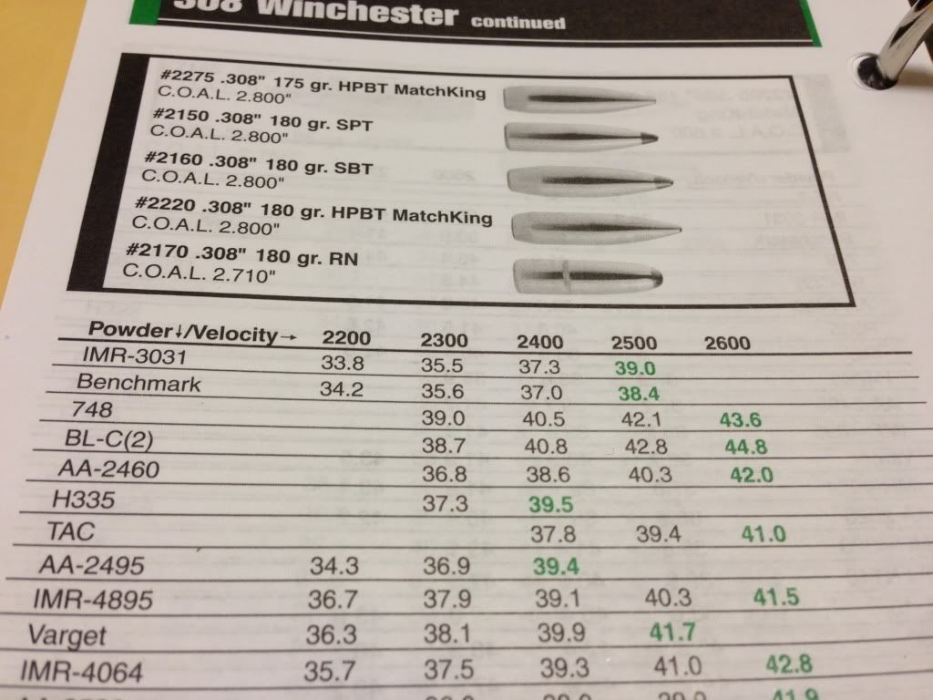

    7,688
    This is from my Sierra book. I don't mow if this will help but here ya go... It shows 41.7 max load for varget.
