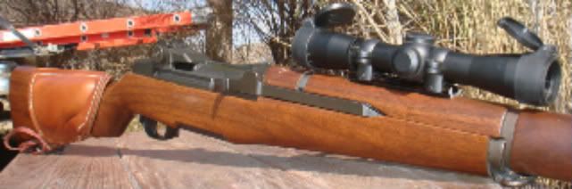

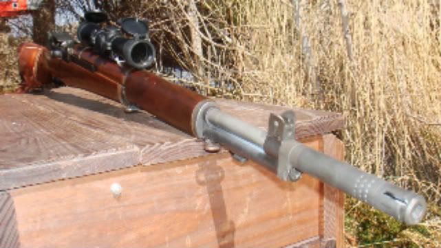

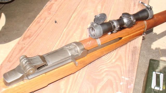

    I got a mix-master H&R Garand from the CMP years ago with some pretty deep pitting on the horseshoe and a tomato stake barrel. I'm a lefty and always wanted a scoped Garand, so I had my gunsmith mount a block to the new .308 barrel to which he then mounted a small piece of rail. I relieved the Boyd's lower hg and mounted a 4x Leupold handgun scope on it. I'm pretty much a purist when it comes to milsurps, I think that is the only non period-correct mod I've ever done to a military firearm, but it's fun to shoot and the rifle was the perfect candidate. No GI parts were harmed in the building of this rifle. I think I have a couple pics somewhere I'll try to get posted.

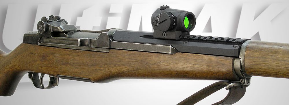

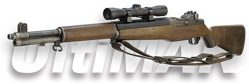

    Ultimak is now offering a scout scope mount for Garands that doesn't modify or damage the rifle in any way. Simply replaces the rear handguard and clamps on, easily removed. I want one for my M1. Model M12, $185.

    Here's my scout Garand.

    Mounted right to the handguard, huh? How well's that work? Seems like there'd be some movement.

    No, the barrel is drilled and tapped for a steel block, and then screwed the piece of rail to the block. I cut out the handguard around the block so it would clear.

    Drilling and tapping? Cutting up the handguard? Changing the barrel? Sorry, I'll go with the M12 first.
