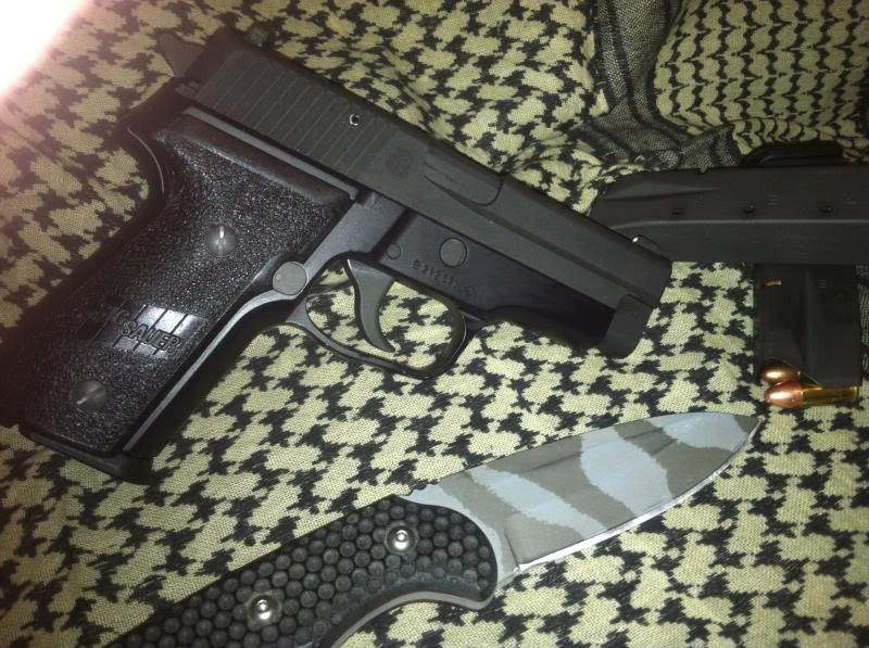

    Well a week or so I picked up a Sig P228 that was a Zurich Police trade in. I did not look shot much but had some honest holster wear ext... It is not a west german but is a triple S/N and it was at a good price. The night sights on it were very dim 2/10 at best. I messed around with the Sig M11 while in service and thought I fresh'n her up again and kinda do a M11'ish rework. I ordered in a set of Meprolights(Yellow rear, Green front) and a new set of springs. Then I tore it down to bare parts and today I put every carbon steel part in the Parkerizing tank to give it that corrosion resistance Sig Markets so well now with the "Not a" M11A1 and the Mk25 pistols. I have no idea what all the parts Sig coats but I said the hell with it and did them all, pins, springs, everything 46 parts in all, and the only thing setting on my bench was a frame and set of grips.... The parts came out looking great and I should have the slide put back together tonight and frame tommorro w/ new sights installed. I will get photos of the slide up tonight and follow on with the frame and whole pistol after that. --USNRigger--

    Well, Anodize is a option. However Id have to find something local'ish and not charging me for a whole batch, or I may just do a cerakote or something. the frame was not as worn as the slide so it may just show some light use/wear. --Update-- I have the slide back together, and I tried taking photos but inside with my camera it just shows up as a fuzzy/furry black slide thingy. I will have to try it during the day or with it all put back together.

    Well here it is for you guys. The only thing on this P228 that is not Park'd is the roll pins on the slide. I had to order a new set as the original larger OD pin was sheared when I got it out. I will be taking them out and Park'ing them next week sometime to round out the whole black theme. Turned out really good and with the exception of the few dings on the frame it looks pretty darn good. I think my M11'ish build worked out pretty good

    Looks Great!
    I carry a P228 for my ccw. Always goes bang, dirty or clean. Dang good guns.
