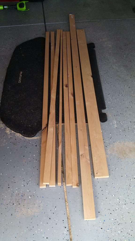

    I decided to make this particular piece out of alder because of its rustic look, it's cheap, and I can get it at Lowes.

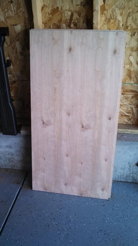

    I'm using birch plywood for the side panels and the back. It matches the alder fairly well:

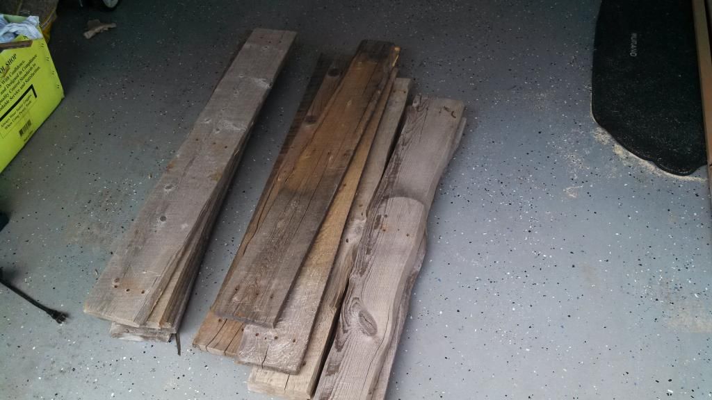

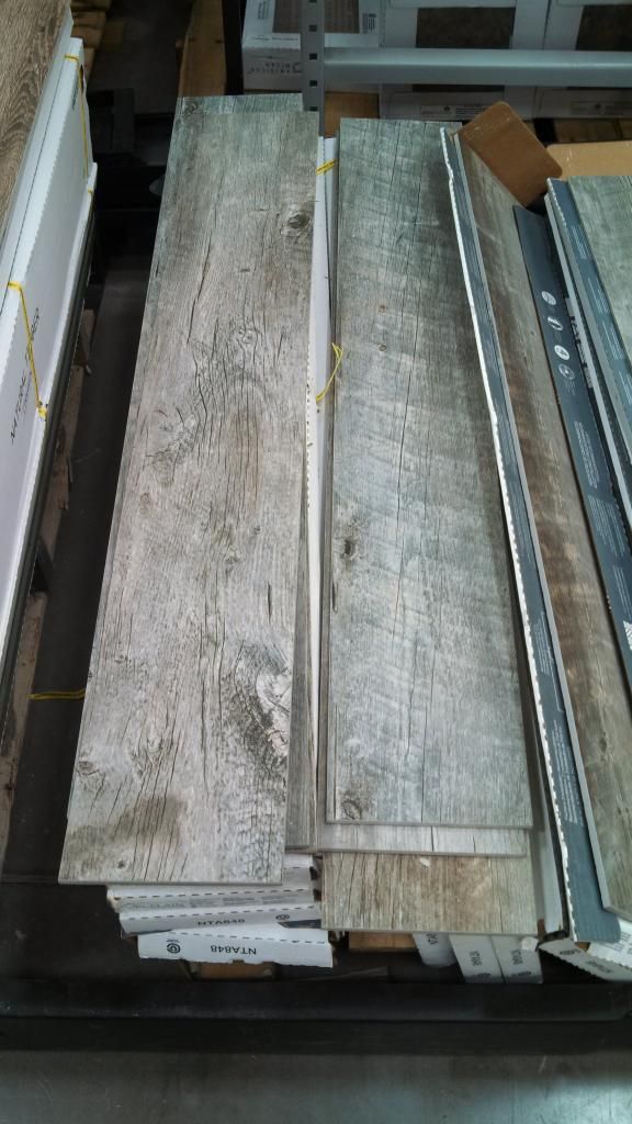

    I wanted the top to be something unique, so I thought maybe I would use these old weathered boards. Splinters would be a daily hazard, but I thought it would look cool:
    Then today I saw this at Lowes. It's tile that looks like old weathered boards, just without the splinters. I'll probably use this for the top. Maybe, I don't know yet:

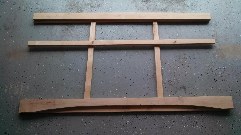

    I just finished the two side panels. The top and bottom rails have a 1/2" rabbet for the plywood to sit in. There will be something on the outside to cover those gaps, I just haven't gotten that far yet.

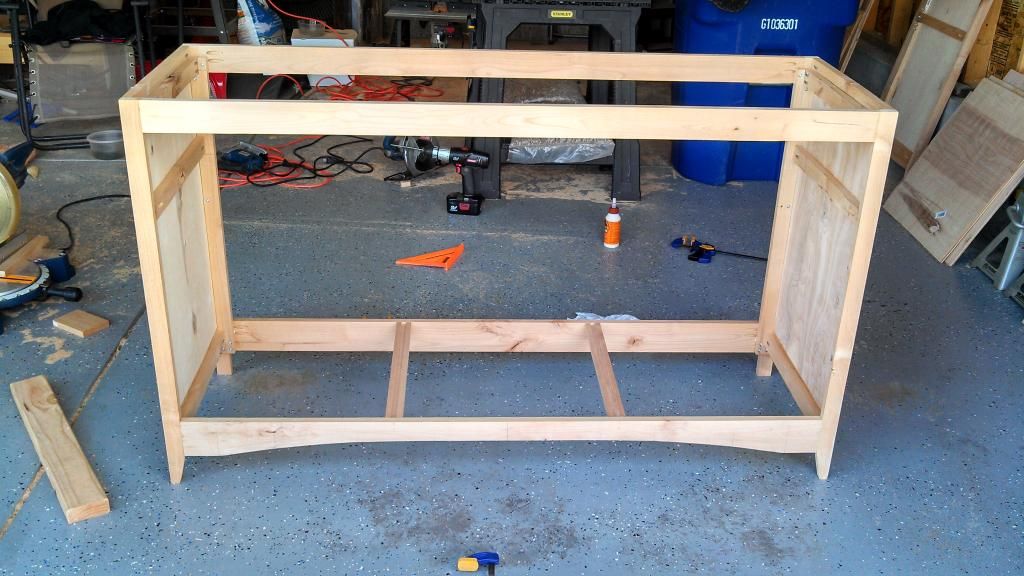

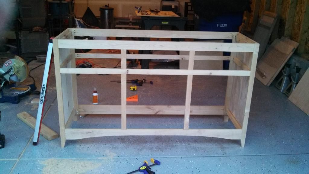

    Here's the basic frame all put together. It's about 1/16" out of square. Not too bad, I guess. There's a little part of me that, every time I try to build something, doesn't believe it will work, and then is really surprised when it turns out ok.

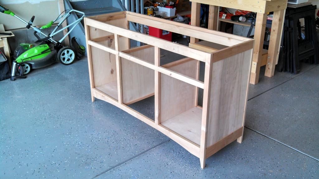

    Here's another pic with the face attached:
    And another from a side angle:

    No wheels on this one, it will just stay in place. Our house has a huge, rectangular room that is about 40'x15' and is the front, dining, and living room, so this will have the secondary purpose of breaking up that space a little and separating the living and dining rooms. I like the pullouts too, and thought about incorporating them, but I *think* this one should be big enough. I think that buffet in the picture is about 3'x18" or so, mine is 5'x20". So hopefully I won't regret not adding those in.

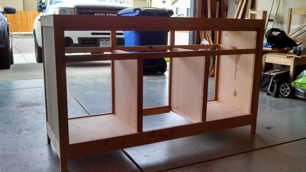

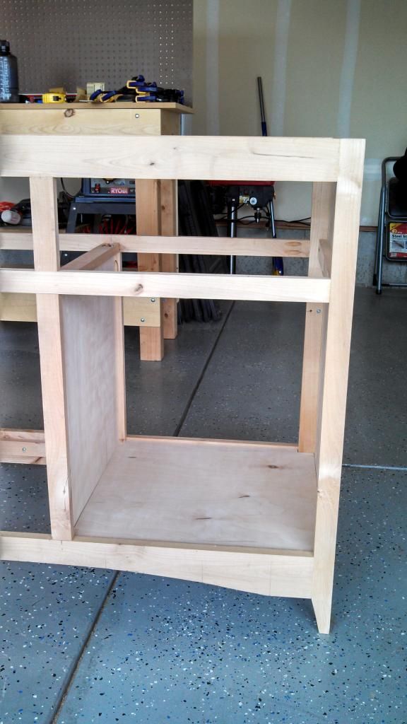

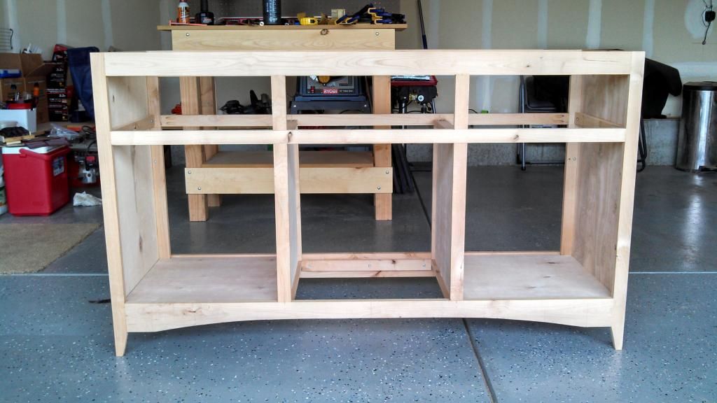

    I got the cabinet bottoms and side panels cut and installed today. What a PITA to get everything to fit relatively flush. But it's lookin' good.
    Here's a front view:
    Closer look at what will be a cabinet:

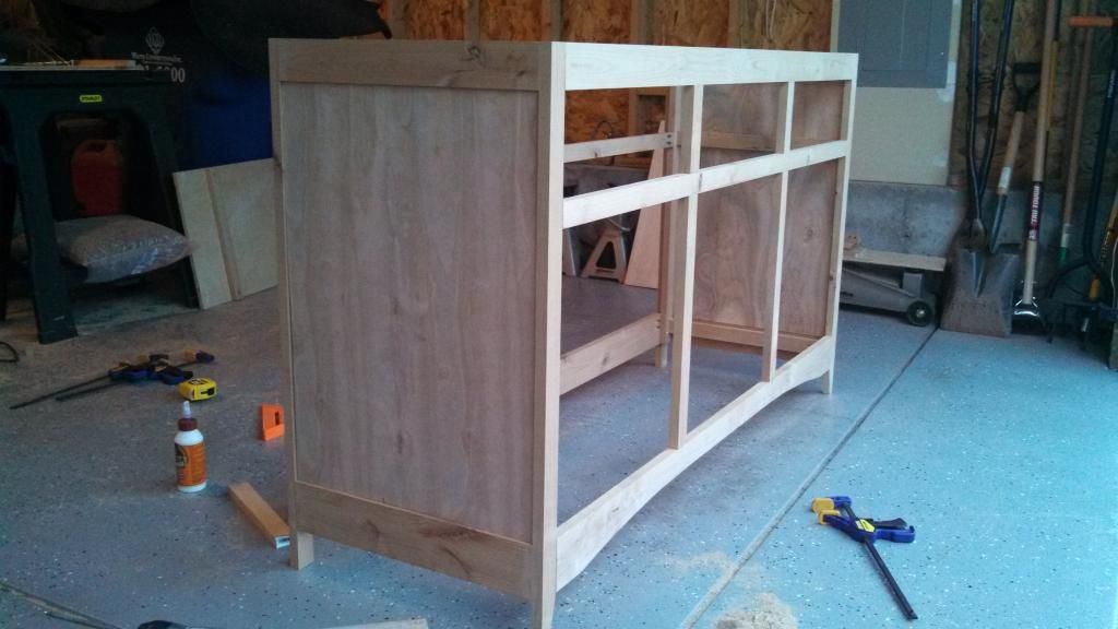

    Back view:
    Another look:
    Pretty soon I'm gonna have to learn how to make and mount drawers and cabinet doors. That should be fun.
