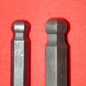

    Don't use the ball headed allen wrenches on action screws. Just rounded out one of the action screws on one of my bolt guns.... Damnit! Talking about the ones in the following picture. They just don't have enough surface area for stubborn factory over tightened screws. Once they rounded it, even using a flat wall wrench was out of the picture. Time to sacrifice an allen wrench, and JB weld it into the rounded screw, let it set, get it off then replace the screw.
    These guys:
