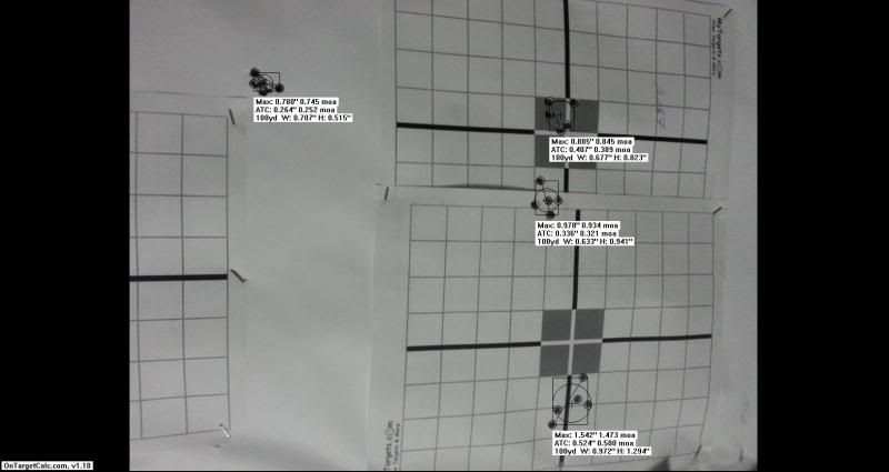

    Below is a pic of my latest testing today @ 100 yds during the beloved wind and at 65':
    Left side: a ladder test of 77 SMK's. 7 shots total. 21.9gr to 23.1 at .2gr increments. No signs of over-pressure of any load. I did pulled the far right round.
    Rifle: Savage 12FV(?) with 16x Millet
    Right top: two different zero groups with 77 SMK's at 23.0 (I already tested that load over the past month)
    Right bottom: British Radway SS109 tested for reference.
    Rifle: Maddog AR15 built with 18" DTI barrel and ACOG TA11.
    I did not chrono any loads due to my dumbarse failing to bring a good battery, but those will follow. As a note with the Savage; I was targeting a round I put in the paper with my Varget load (24gr @2950 FPS) with a 3 MOA adjustment down (you can't see it from from my shitty photography), and it was spot on. Which leads me to believe the velocities are close...
    I also have promising results with .308 with 175 SMK's with my "Maddog built" LR308 during my initial ladder testing, but I did not take pics. Those results will also follow...
    Long story short: if you guys like Varget, you may wish to give IMR4320 a try!

    Found an old picture of a work-up 7 shot group in .308 with 4320.
