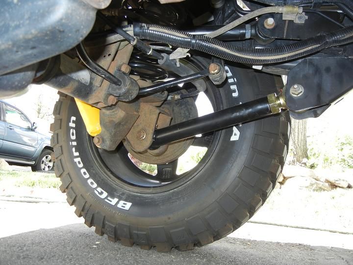

    NICE ride , from what I can see of it.
    Jan 2005
    Wheat Ridge
    1,570
    Holy huge picture Batman.
