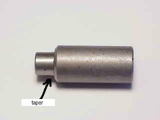

    This is an Expander Plug, the center is hollow for the powder to fall through. Right in front of the shoulder there's a tiny taper that bells/expands the case mouth, and the shoulder limits the amount of belling/expanding. When the case hits the shoulder, that pushes the plug up and operates the powder measure.

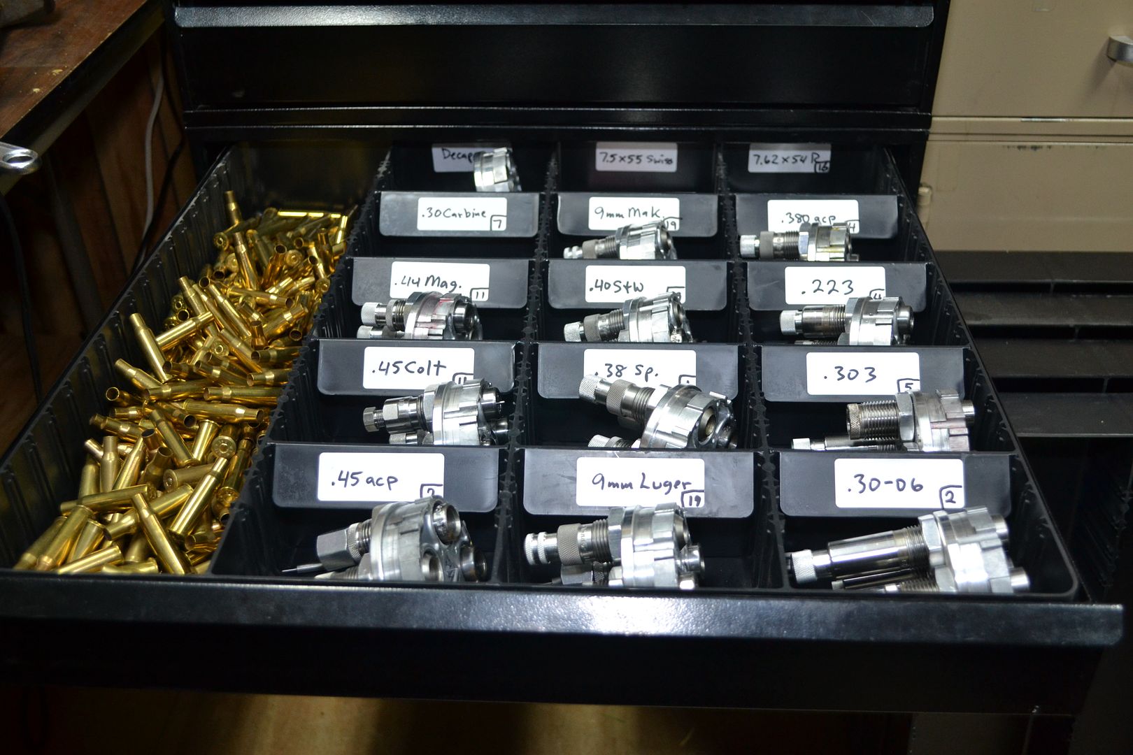

    Some guys will buy an Auto Disc or Auto Drum measure for every set of dies and leave it mounted on there. I'm too cheap for that, and that won't work with my die storage method either. But getting a turret for every set of dies and leaving the dies mounted in the turret is outstanding, works very well, they're always setup and ready to go. I have a turret with a universal decapping die in it, one with a bullet puller die, and one with an RCBS powder measure in it. Extra turrets come in very handy.
