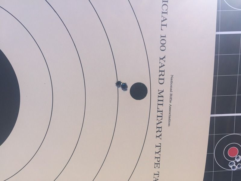

Before. Red is SCAR17 without the 762SD can (10 shot left, 5 shot right). Blue is 5 shots with the 762SD aiming at the right target... WTF!!!
After. SCAR17 with 762SD 168gr match no wind 60-65 degress bipod sitting. 10 shot group, called the flier.
Then i grabbed the Rem700 100 yards 168gr match no wind 60-65 degress bipod sitting. 3 shot group. My personal best so far with any rifle in my life.
