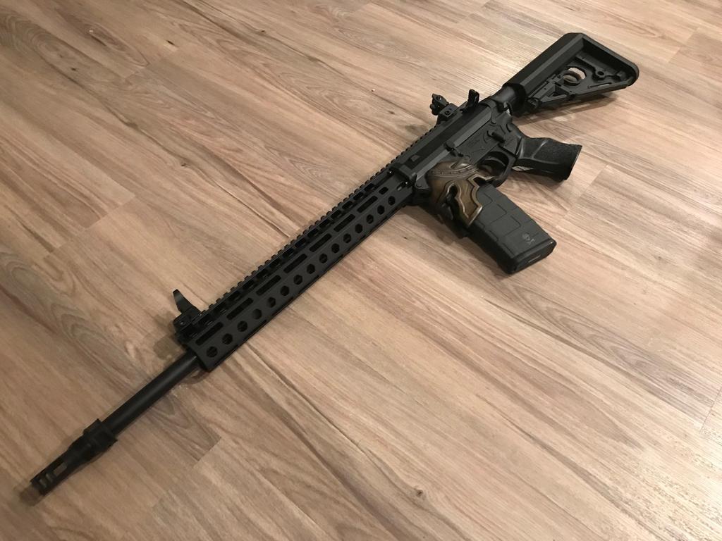

    We just put one together for my dad using LaRue's upper. Pretty badass rifle and hopefully we will take it out this weekend. He put it together for deer/elk.
    I put mine together with the intention of using it for hunting. For me hunting is way more about walking around with a rifle than actually shooting a critter so I tried to keep mine short and light.
    SouthPaw, I'm assuming the magazine in your dads rifle is just for decoration? Or are you managing to use 5.56 mags with the Grendel?
    Yes, just for photos. He picked up some Elander mags but curious to compare them now. Surely someone has tried using regular pmags before.
