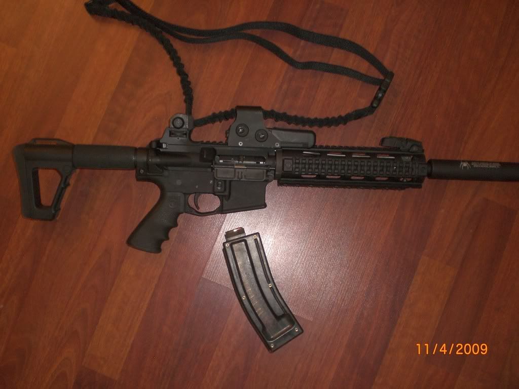

    Ok - I searched and didn't find anything specifically relating to my trouble - so here goes:
    I recently received my long awaited Ciener .22 kit for my AR...
    and it doesn't work.
    It fits in the gun - but when you close it back up (put in the pin) it binds and it will not charge (the bolt only pulls back about 1/2 way and stops)
    Looks like it is not machined on the contact point where it meets the hammer?
    I'll try to get a picture up...
    Anyone else encounterd this problem before?
    I wonder if I should just send it back to Midway and if I do - what if I get another just like it?
    I have an opportunity to learn something here, I believe...

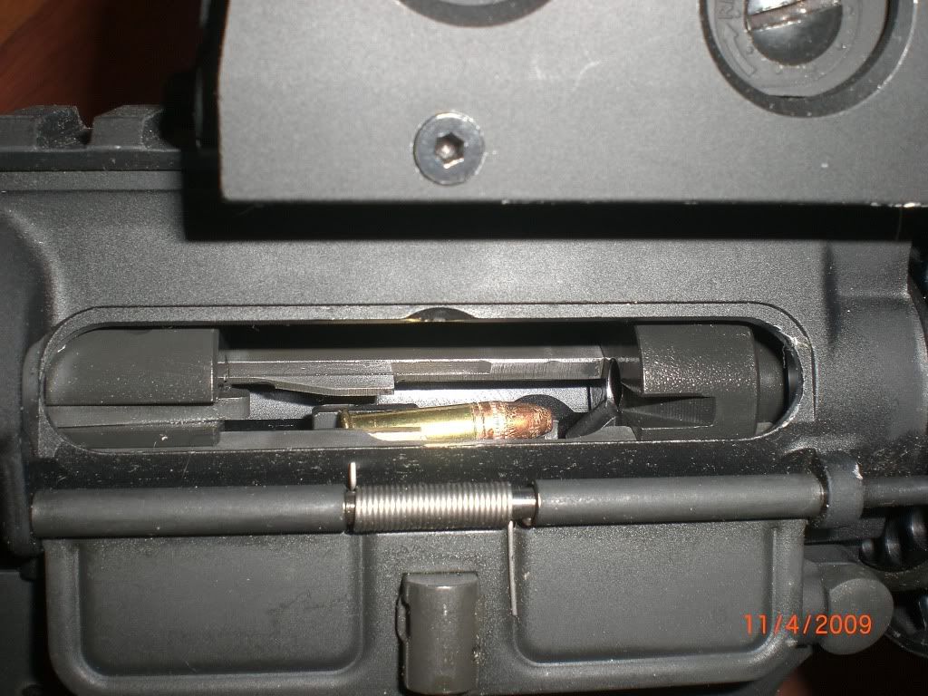

    Here is the pic - the red circle is the area that doesn't look machined and seems to bind.

    It only pulls about halfway back, by design. As long as the bolt face clears the back lip of the magazine, and cocks the hammer, it's going back far enough.

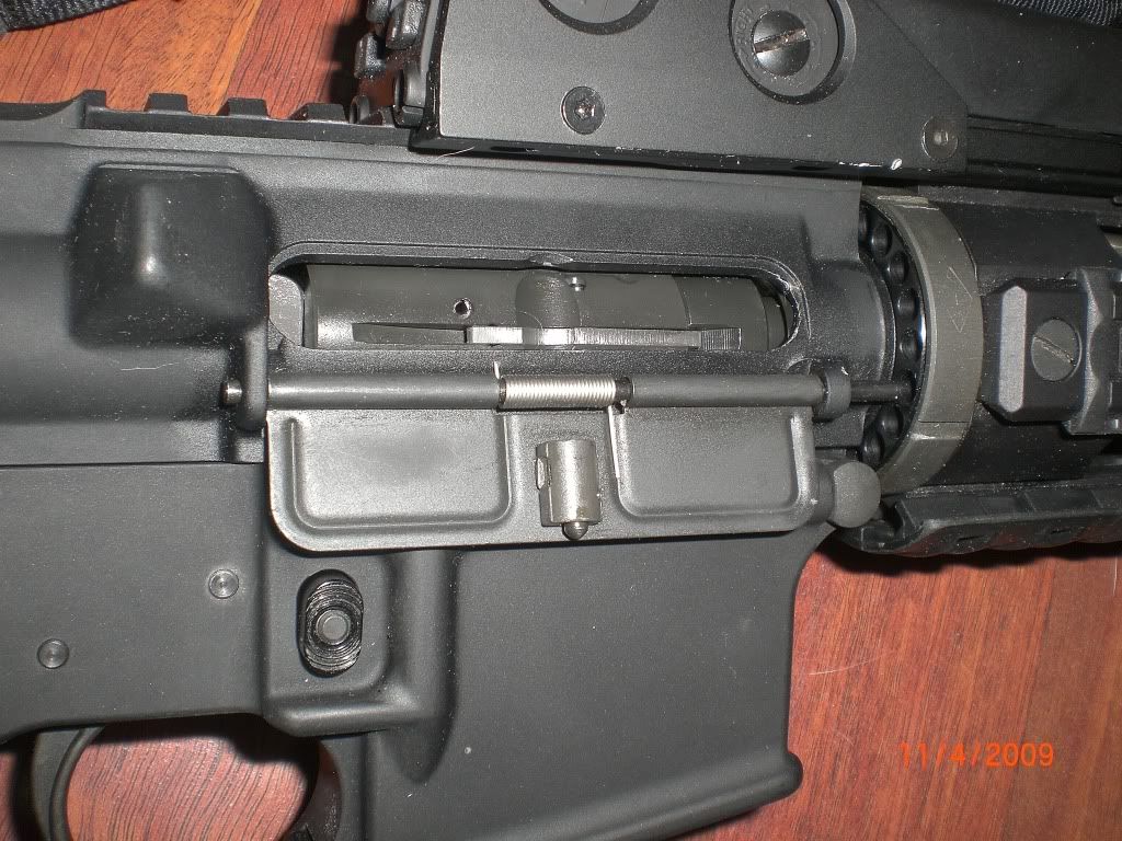

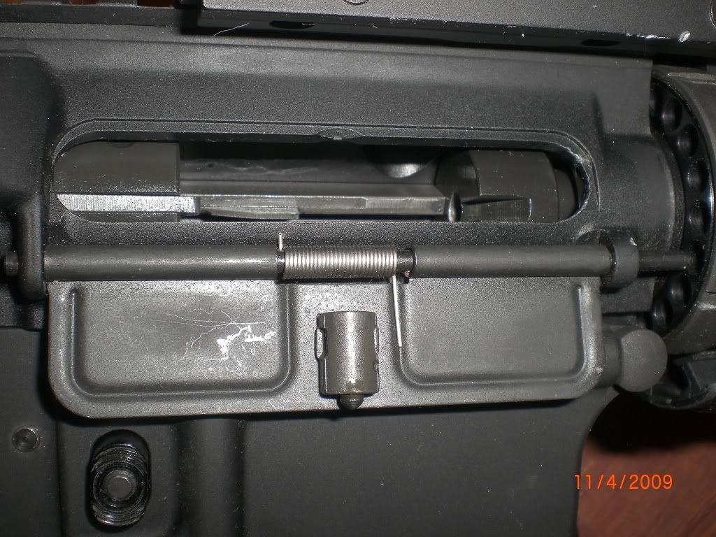

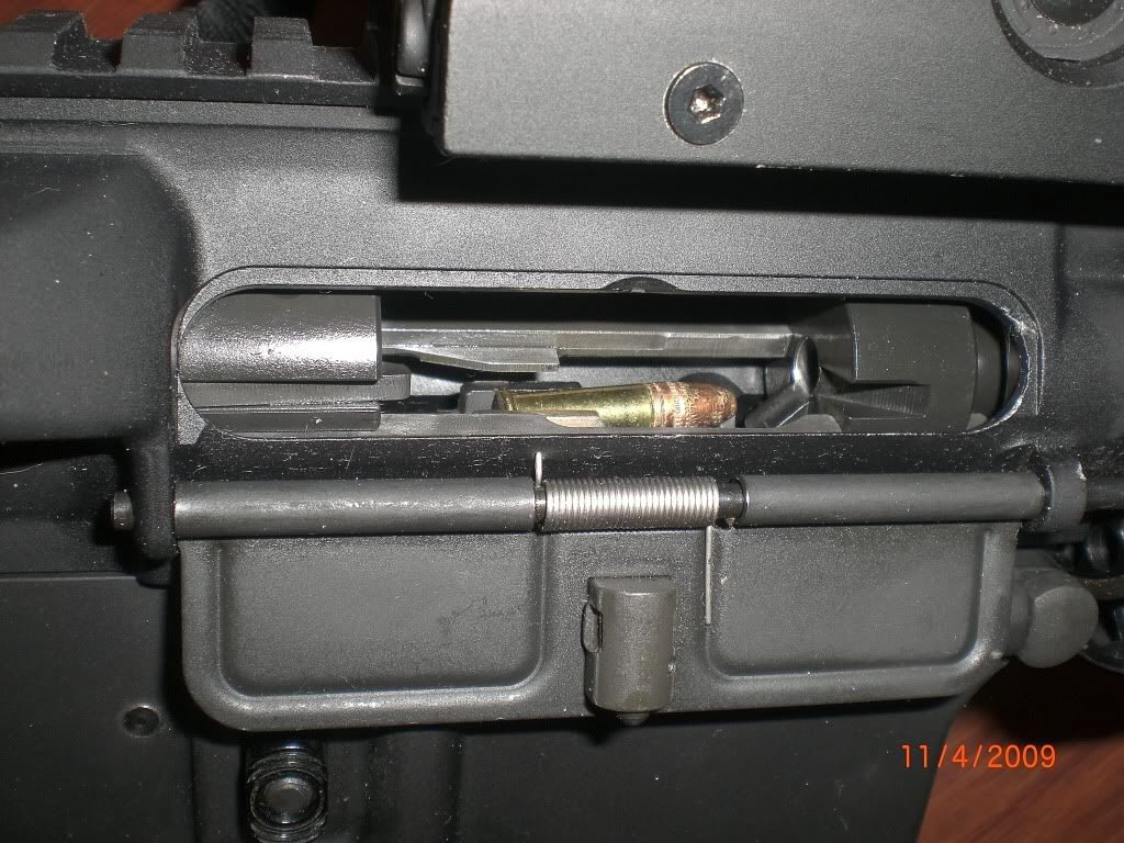

    Mine just pulls back - doesn't release and go into battery... I'll see about pics tonight when I get home...
    can you post pics of the other side?
