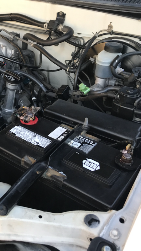

    So someone smarter than me may be able to point me in the right direction. I have two similar issues going on with two separate vehicles. Both batteries have been replaced a year ago.
    2014 GMC Terrain - Car was having trouble starting last year so I went to test the battery. Upon inspection, the negative cable was so corroded, I actually pulled the post out of the battery removing it because it was seized. Battery was replaced with a Napa Legend 75 series. A week ago, car went into limp mode with every light on the dash on (ABS, traction control, stability control, check engine, oil pressure, etc) while driving on the highway. Pulled over, shut off and restarted. All lights were now off except the check engine light which was for fuel circuit voltage high or something similar. Drove fine the rest of the way home. Once I got in the garage it seemed to me like a battery problem so I inspected the cables. Again, the negative cable was corroded but not quite as bad this time. I got it apart, cleaned it all up and sprayed some corrosion protective spray on it. During this, there was one tiny wire with an eyelet attached to it that ran along the negative cable and attached to a small ground bolt right before the terminal. Both the eyelet and bolt were corroded and while cleaning the eyelet, it snapped off. I cut it off and replaced with a new one so I am thinking maybe that was for some BCM or possible ECM ground that was on its last leg. Has been fine so far with no issues.
    2000 Tundra - Battery was replaced a year ago with Napa Legend 75 series. On this truck, the positive cable gets heavily corroded and the battery leaks through the caps. About six weeks ago, I removed the cables, cleaned them up, sprayed protectant and put those cheap little felt pads on it. This morning, the battery was dead and had to be jumped. As you can see from this pic, it has been leaking enough to start eating the paint off the hold down strap.
    So I have one vehicle that corrodes the negative cable and one that corrodes the positive terminal. I don?t think it?s the batteries as the Terrain was already doing that to the OEM battery. Any ideas what to start checking out?
  8. #1388
    3,117
    Went and got the tundra battery tested and it was bad. Rated at 875cc and tested at 486cc. Hopefully that was the cause.
