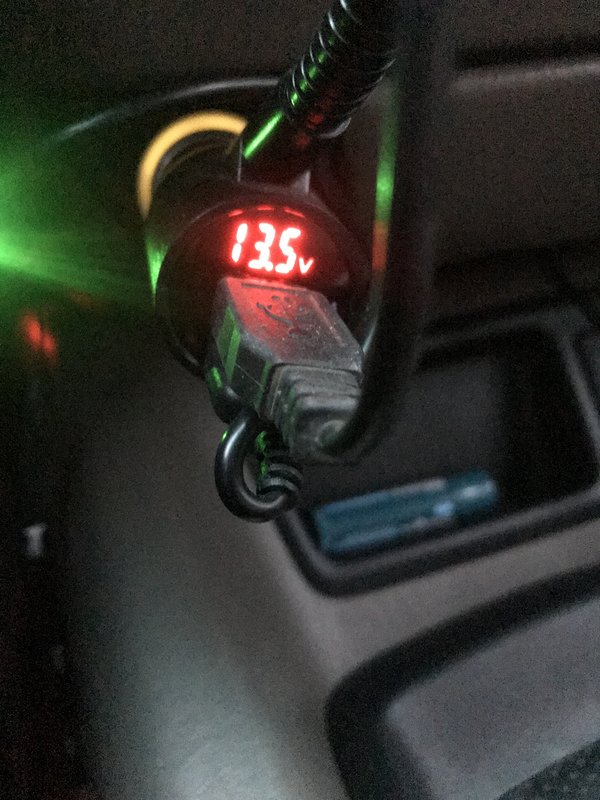

    Compare your readings with a good quality DMM (digital multi meter) to see how accurate your cig volt meter is.

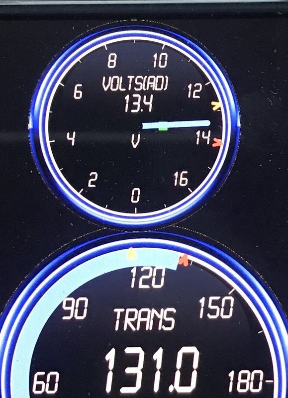

    So while driving, it holds a steady 13.4-13.8v. It holds the same at idle until I put the high beams on, heater full blast, all light bars and rolled down the windows. When I did all of that, the engine bogged slightly and volts dropped to 12.7 for about 3-5 seconds and then picked up back to normal.
    As you can see, the Torque App records the lowest and highest readings. Lowest 12.7v and highest was just over 14v.

    Your voltage from the rectifier/regulator is good, check, clean & tighten the connection at the starter solenoid where the wire from the aleatory connects to the positive cable from your battery. Also check, clean & tighten all grounding cables and braided straps. Use an ohm meter to test resistance from end to end for internal resistance caused by corrosion, even if there is none visible.
    Other than that, try a new quality battery, some parts store brands are not as high a quality as even as little as 10 years ago.
    Even the battery in my wife’s, bought new, 2018 Honda didn’t last quite 2 years, and it is always garaged.
