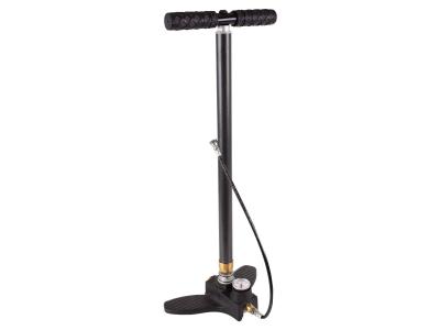

    I have a handpump -- sort of like an overbuilt bicycle tire pump -- as well as an adapter that lets me fill cartridges from a scuba tank.
    https://www.pyramydair.com/s/a/Air_V..._4500_PSI/9654
