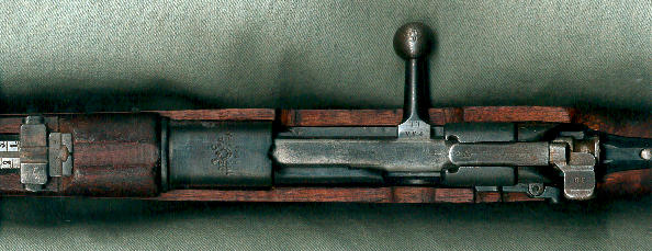

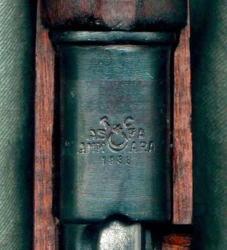

    [quote=Marlin;322944]BINGO!
    http://www.texastradingpost.com/m88/turkconversion.html
    It just might be 8MM
    ETA: Does your reciever mark look like this?
    That's it exactly... so details, this is a 8mm? We are having a bit of trouble taking the lower wood off the barrel. Have a dissasemble technique?
  3. #33
    Aug 2003
    Westminster,Colorado
    10,139
    Did you look at the link?
    Couple of links in that one that should get you a little more info.
    I just figured after reading your description, There was no way it was a Nagant..
    And the pictures confirmed it.

    After more research it does seem to be a 8mm Turkish mauser... however, the bolt does not match the original (different numbers too) so it must be a replacement... so much weirdness... this is why I prefer newer firearms.
    However, everything is clean and gtg. Thanks for all the help suggestions, etc.

    I'd say you have a Turk GEW88 there. http://www.turkmauser.com/gew88/
    If they actually told you that was a Mosin they are nuts. The mag does look similar but that is about it. The bolt release on the side should have been a giveaway at the least. Not to mention the receiver, bolt, sight....and on. lol
    Glad you didn't waste any money on 7.62x54 ammo. I'm guessing their mention of conversions might have been in reference to some mausers being 7mm and them being converted to 8mm later. This is actually why most 8mm mauser commercial ammo is actually load pretty light. Just in case you fire it off in a 7mm rifle.
