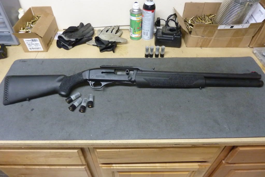

    I picked up this shotgun used for $700 two years ago, without knowing anything about them. It just looked meaner than a caged baboon and I jumped on the man candy. I had a 1100 comp master at the time, and it was OK, but when I took this new gat to the range, it only took a few shells to realize just how dated the 1100 platform has become. I was dabbling in 3G at the time, so I started working on smoothing out a few small wrinkles in what is otherwise a wonderfull firearm. In factory form the SLP was simply not designed to be loaded easily. There really isn't much on the internet regarding the SLP to help a brother out, so a quick look at the Benelli M2 for comparison purposes told me where to remove material.

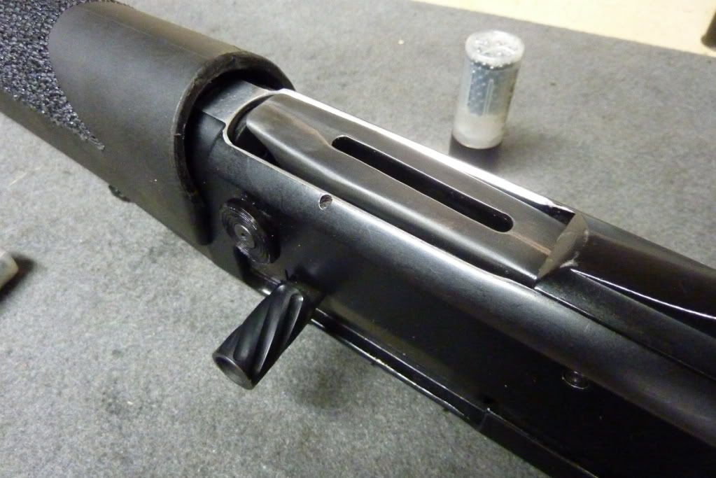

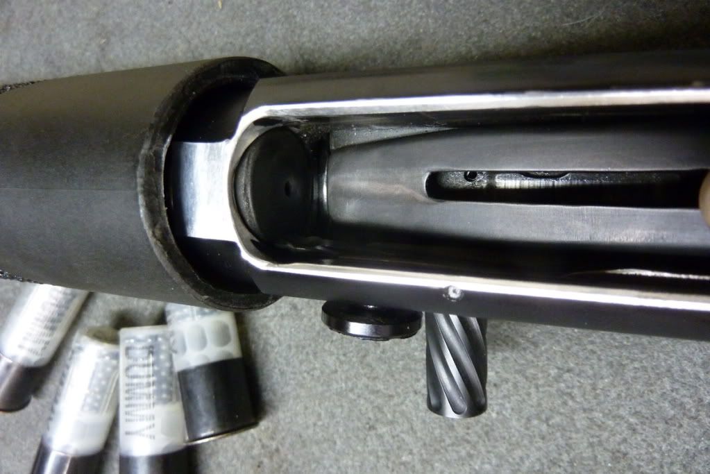

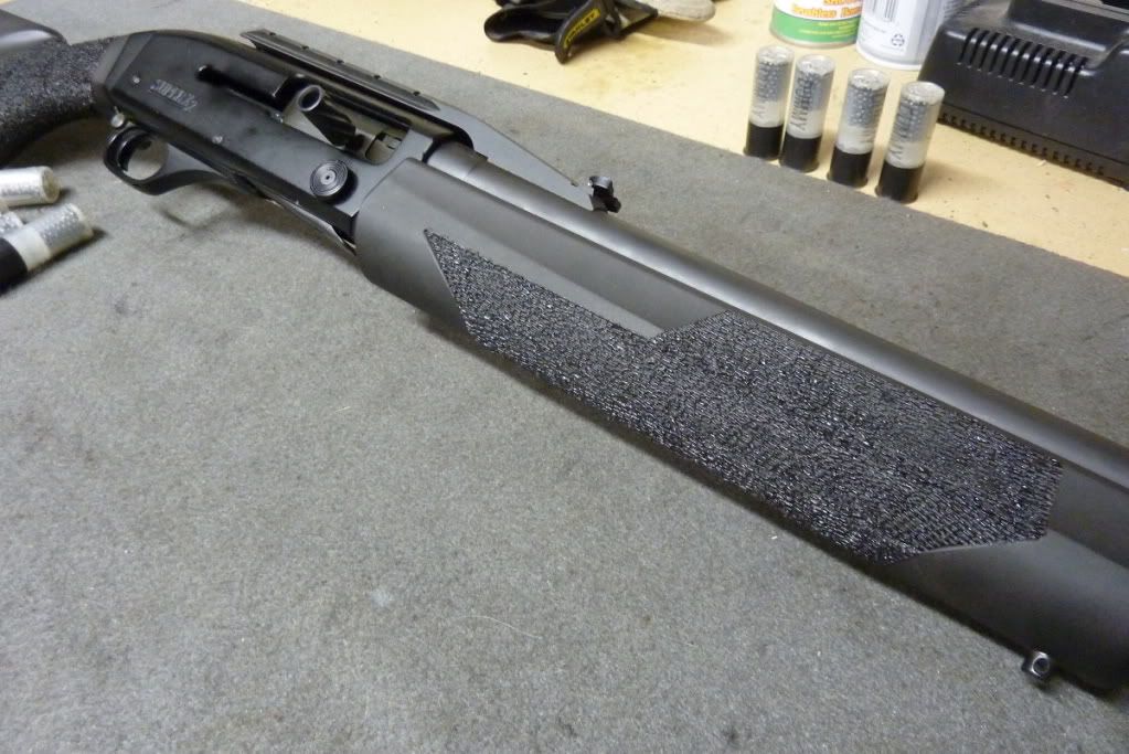

    I follow a machinist mindset when working with machines. You can't put material back on, so I tend to go very slow when performing personal modifications. Step one was to cut back the overhanging handguard as it was blocking part of the feed port. The feed port was relieved a bit so you don't have to shove your thumb down the mag tube to lock the shell. I bevelled the feed port and put a chamfer on the opening of the feed tube for a smoother feed. I relieved the bottom of the receiver, so that the shell doesn't need to be pushed up so aggressively to find the mag tube. Its rare, but the upward traveling shells can get caught on the bottom of the barrel where it protrudes into the receiver. A small amount of radiusing on that bottom corner eliminates this problem and polishing the underside of the barrel hood eliminates the bolt and carrier tendancy to some times not go fully into battery. Again, this was a rare problem, but not any more. Finish the parts off with a C-rums follower (well worth the $45) and a Nordic charge handle and button completes the parts package. This shotgun shoots absolutely outstanding. Very smooth and very fast and very reliable with about 3k shells down the pipe.

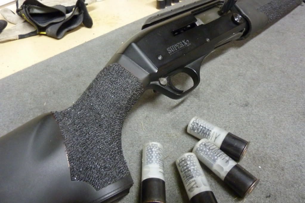

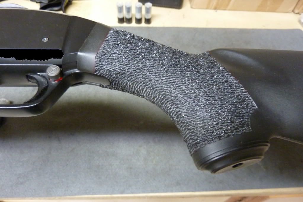

    I have been learning weak hand reloading and am getting the hang of it, but lately I've been trying to load weak hand off the shoulder. If the SLP has one fault its weight. She's a tad on the heavy side and with oily hands it is a chore to hold it up while reloading. I got a wild hair and decided to try my hand at stippling. The result was far better than I expected and the additional traction gives so much better grip that the shotgun feels 1-2lbs lighter when reloading off the shoulder.
    The Salient Benelli is to die for. I mean, even God wants one, but if you don't have the scratch for unobtainium, don't feel like you are selling yourself short with an SLP. With a little messaging, you will have a shotgun which shoots every bit as well. It's a little heavier, but it also has less muzzle flip and felt recoil. Honestly, this thing runs so well, I may never part with it. Anyway, here are some photos.

    So forgive my ignorance; why does it say Super X2 on the receiver and is Winchester okay with this behavior?
    Either way, great looking shotgun.
    I think the stippling looks great on there. Well done.
    I can see where you took some material off on the receiver, but without before pictures, it is difficult to tell how much. It looks very well done though.

    Good eye. Your right in this technically being an SX2 Practical. They are exactly the same as the SLP, with two small differences. This is a 2.75" chamber only, where the SLP is a 3". FN must have changed the hammer spring. The only failures I ever experienced was a short period of misfires. I heard a nasty rumor that the SX2s suffered from weak hammer springs, so I replaced mine and bingo, no more failures. I wrote this up as an SLP cuz no one knows about SX2 Practicals, but everyone's heard of an SLP and they are essentially the same gun.
