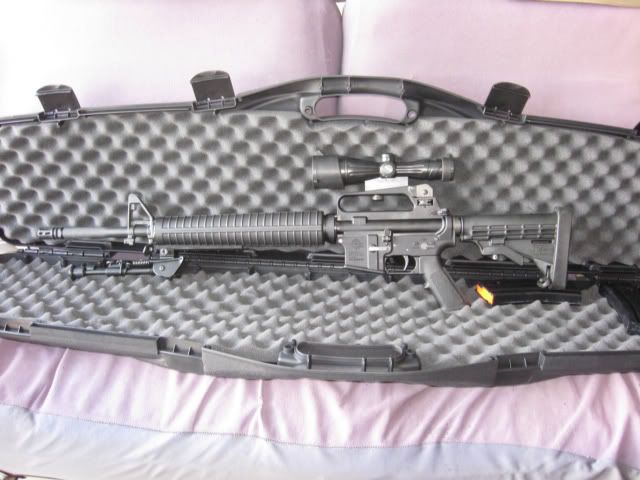

    IMHO, Why not? It works well, an ACOG type is great. I no longer have this scope on it, I just bought that cheap one to see how I like a scope on the carry handle. I now have a Nikon on it. I like it very much. You are not looking much higher than iron sights and you still have a cheek weld. You could go with a red dot the same way, it would be much smaller. I'd buy a inexpensive one to see how it works for her. If it doesn't work for her, you can mount it on yours Primary Arms makes some highly rated clones that are inexpensive. I wouldn't change out the upper on a new RRA. Why mess with a lifetime warranty? If nothing else have RRA change it out for you. There are also get some really inexpensive uppers out there now a days, closer to the $350 range.

    I picked one up at the gun show yesterday and absolutely couldn't keep my cheek on the stock to look through the scope. Maybe it was set up differently than yours but I didn't like it. Of course, Lisa will have to make the final decision on what she likes or not.

    Sorry about that, I guess it doesn't have as much of a cheek rest as some people might like. It is very comfortable for me, but I shoot prone with a bipod. A complete A4 upper is only $145 from RRA, keeping the rifle original. One last idea, they make butt stocks with adjustable cheek rests.
