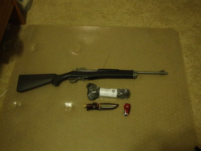

    1) THe first thing you need to do is gather your materials: A knife, a lighter, something to start the sling on, and some paracord (it took me roughly 1.5 feet of cord per inch of sling, but YMMV)

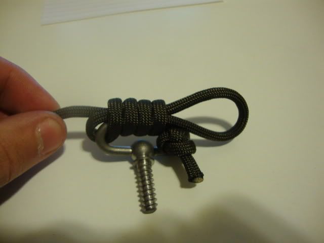

    3) So once you've made the 4 loose loops around the starting point, take the working end and fold it together into a loop as shown:

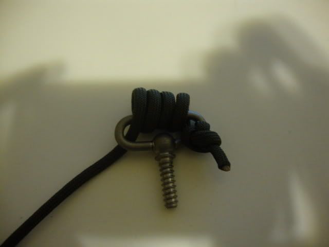

    4) Then you take this loop and stuff it through the 4 initial loops you made like so:
    5)Next, you cinch down the 4 loops (not too tight though):

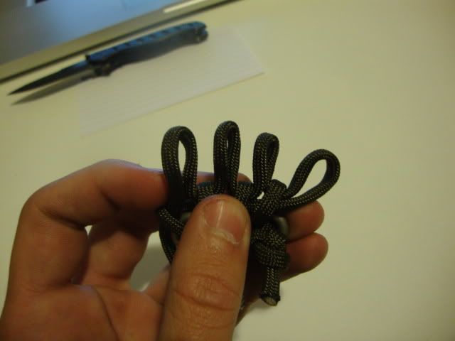

    6) Then, you separate the cinched down loops and pull up 4 more loops through these openings. (Hard to explain, this video does it well though):

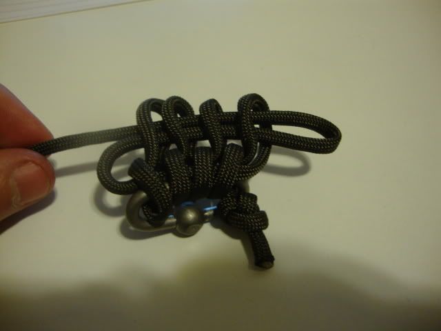

    7)Once you've done this, you take all the loops and rotate them counter-clockwise (the left side of each loop should be facing you). If you forget one of them and it goes clockwise, it looks pretty bad so don't do that.

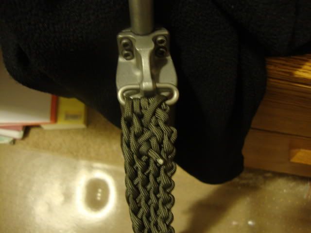

    12) Once you've reached your target length, cut about 1' of extra paracord and loop around your swivel 4-5 times. Be sure to fuse both ends of the paracord so they don't unravel. Now you can either tie a knot at the top of the swivel or weave the excess back into the sling (this is what I did because I think it looks better than a big 'ol knot at the end).
    Now if you're making a belt and not a sling, I weaved a layer of 3 loops instead of 4 to taper the end, and then I wrapped it back upon itself a couple of times to round the end. The end is really up to you, so tie whatever knots or abominations of knots that you want to finish it off. Just make it look good to you.
    Here's what the finished product should look like:
