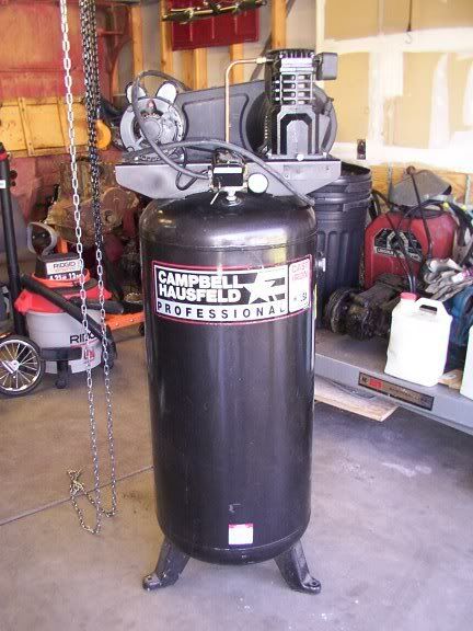

    FWIW, I found this one on Craigslist for $150. It's a cheapo, not a pro model, but does what I need it to do. My beadblaster will get it huffin' and puffin', but it does fine no more than I use it. I was lucky and called dibs on it as soon as I saw the ad and hauled ass there to put down a deposit. The seller said the phone rang constantly after I called, but I was first. He sadly realized he'd priced it way too cheap.

    I have a Craftsman 25gal the does just about everything. It can even bust nuts with a 1/2" impact, I'm looking at a body swap, on the truck, this summer. This compressor is just too small. Looking at something that can handle soda/media blasting. Plumbing the garage is also in the cards.
