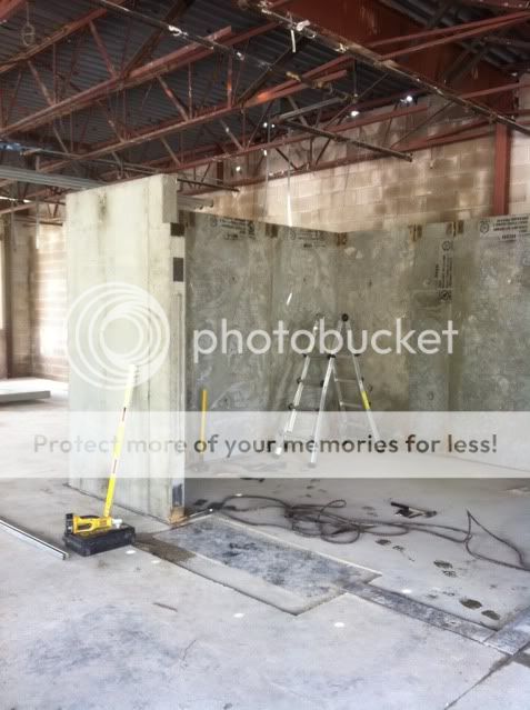

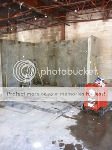

    Built a vault last Monday and Tuesday and snapped some pics with my phone as we were building it. This would make a sweet gun room

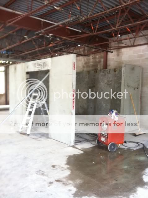

    After I shot in the shoe plates I started to weld the walls as they were being placed:

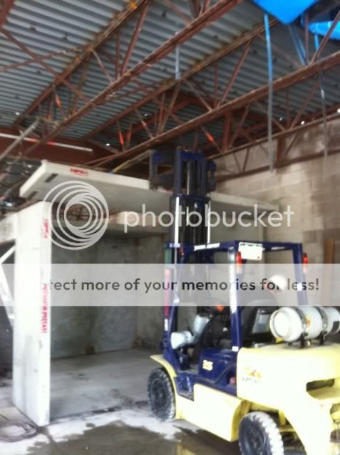

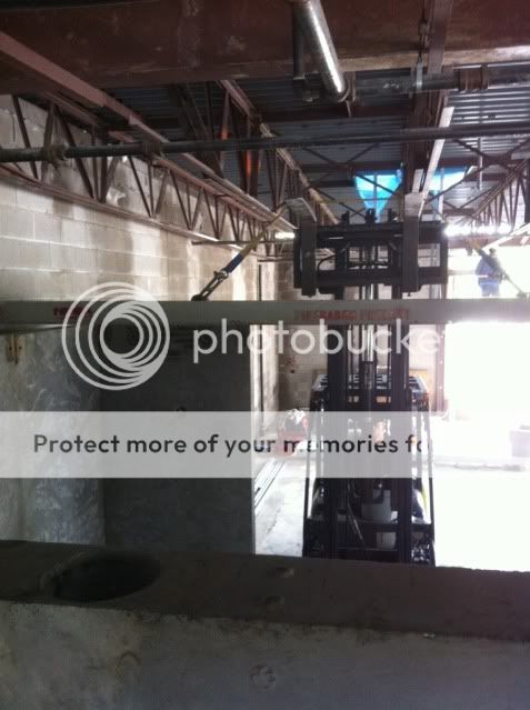

    Usually I stand all the walls up and place the header first but since this was being built inside a gutted building, the maneuverability(sp?) was tough so we built three sides and left one side open to drive the forklift in to set roof panels:
    Secure Lock & Safe

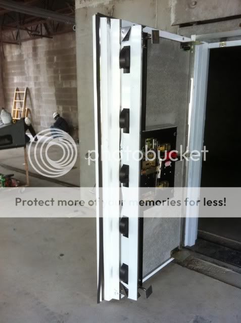

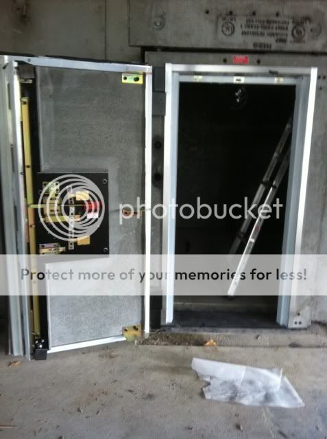

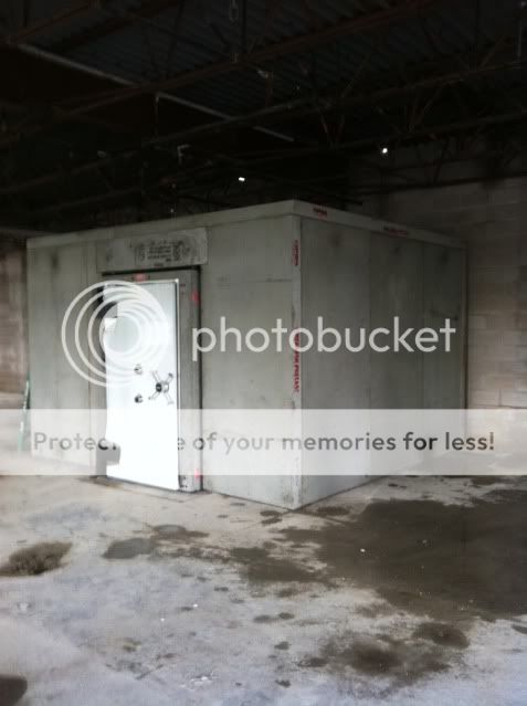

    Here's the finished product I do, contactor does all the finish detail work:
    These are some serious locking bolts...This door weighs close to 6k lbs

    do you set the steel in the slab?
    Chapin, SC
    2,923
    No the panels come from factory all prefabbed. All I do is stand 'em up, make 'em plumb and weld them together...sounds easy huh?

    Nice looking vintage Lincoln buzz box. Looks like its in pretty good shape.
    Yea that welder is awesome. I bought it a little over a year ago with only 25hrs. on it. I've used some of today's best welders with the newest technology and I still like this old Lincoln!!
