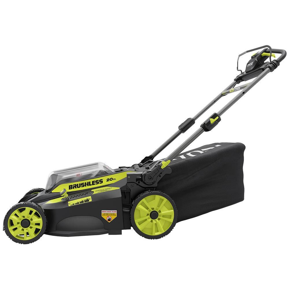

    I had a problem with the dust and the ethanol. I wanted an easy way to solve the problem
    https://images.homedepot-static.com/...-y-40_1000.jpg
