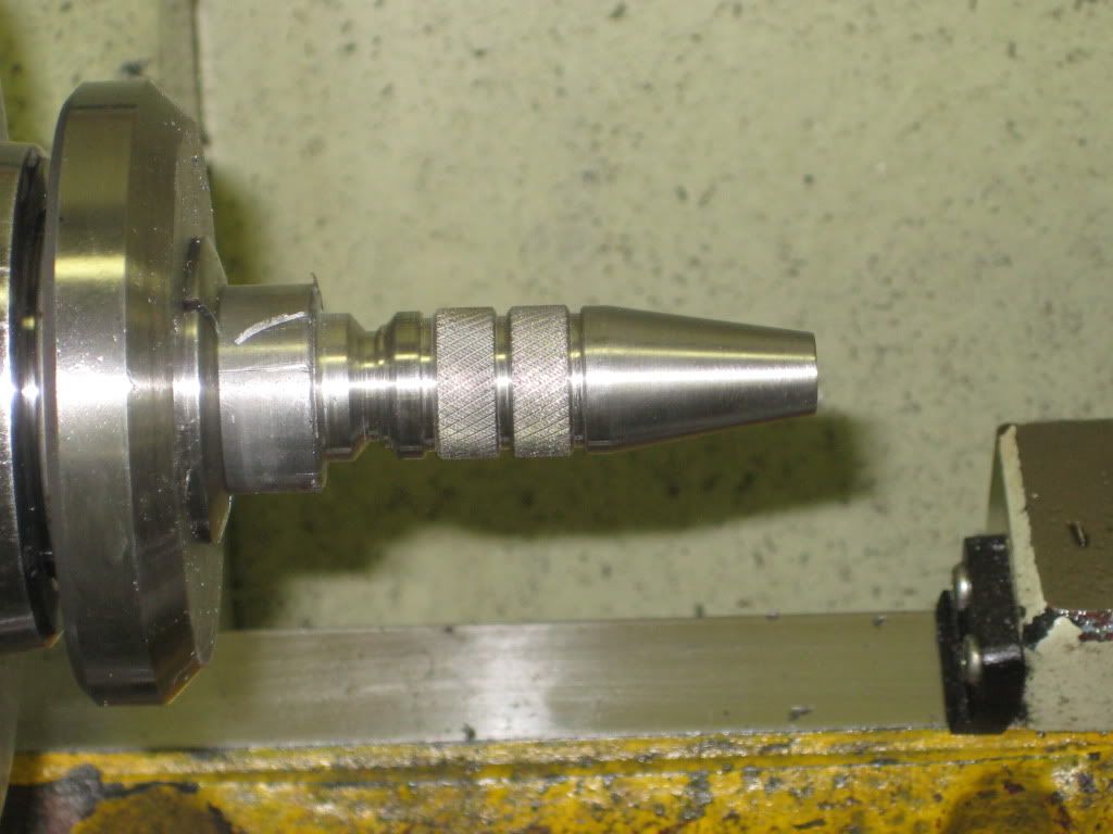

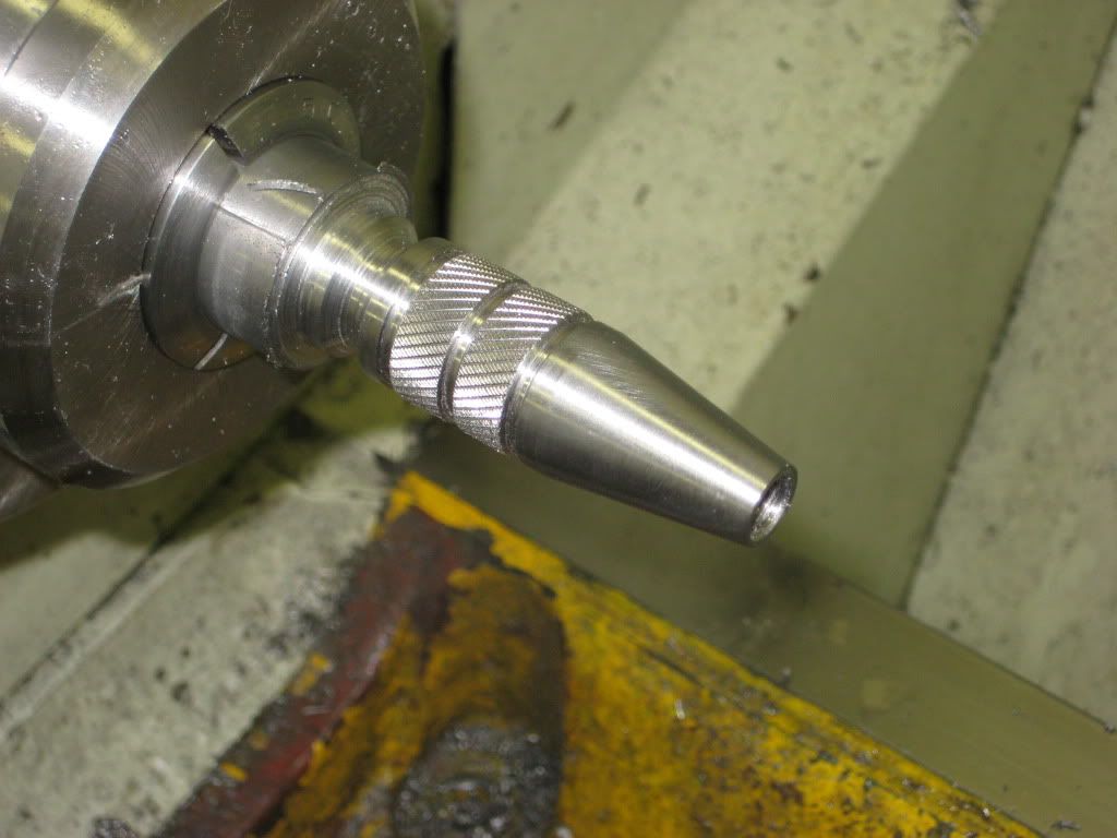

    Well-the Timney 510 came in today and I was thinking about a decent bolt knob.
    After perusing the net and catalogs I just didnt see one that really tripped the trigger.
    What to do now?
    Hell with it-I made my own out of some cold rolled stressproof I had lying around.
    .715 in diameter, 2.070 long-threaded 5/16th x 24 TPI (Although I may bump that out to 3/8ths x 24 TPI).
    Heavy knurling.
    I havent parted it off quite yet-might do a little more detail work on the end.
    Got some parkerizing to do this weekend and I will park it- should look pretty good parked.

    if I ever get a remington 700, I think I'll have you make one of those ^ for it.
    Cant wait to see what it looks like on the gun
