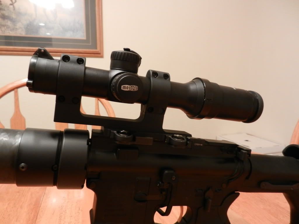

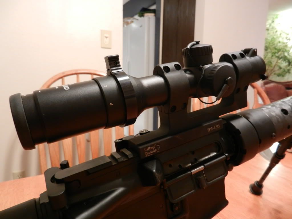

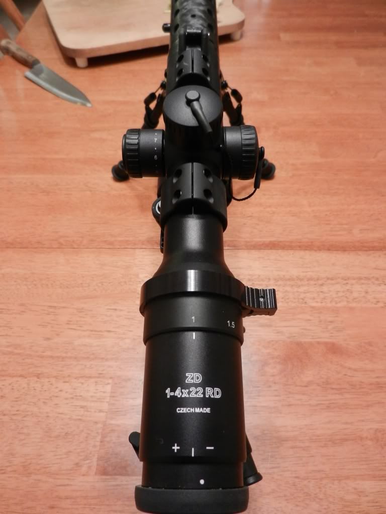

The new model is compact and attractive. A nice deep black anodized and bead blasted surface finish looks good. There is a rear dioptor adjustment ring which has a wide range of adjustment and turns with a pleasing amount of tension. Likewise the magnification ring turns with just the right amount of tension and is smooth. I installed a 3Gun Stuff scope ring which fit perfectly. It's both light weight and attractively finished. Yes,the old Meopta scope ring fits the new model. http://www.3gunstuff.com/

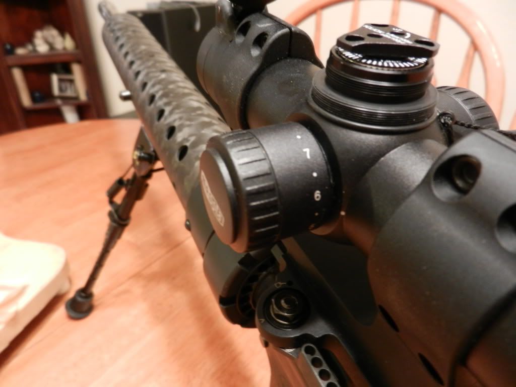

The turrets are adaquate and par for a sub $1000 scope. The clicks are possitive and Meopta added raised, triangular finger pieces so they can be adjusted without tools. There is no rezeroing feature, nor is there a zero stop feature. They are only adaquate and nothing to write home about. I didn't bother testing the return to zero properties because these types of turrets are generally designed to be set and forgoten. I'm quite certain I will. The illumination knob is pretty much standard fare. An on/off style knob with increasing intensity and off between each setting.

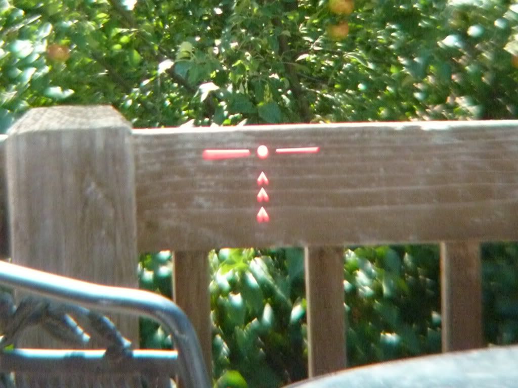

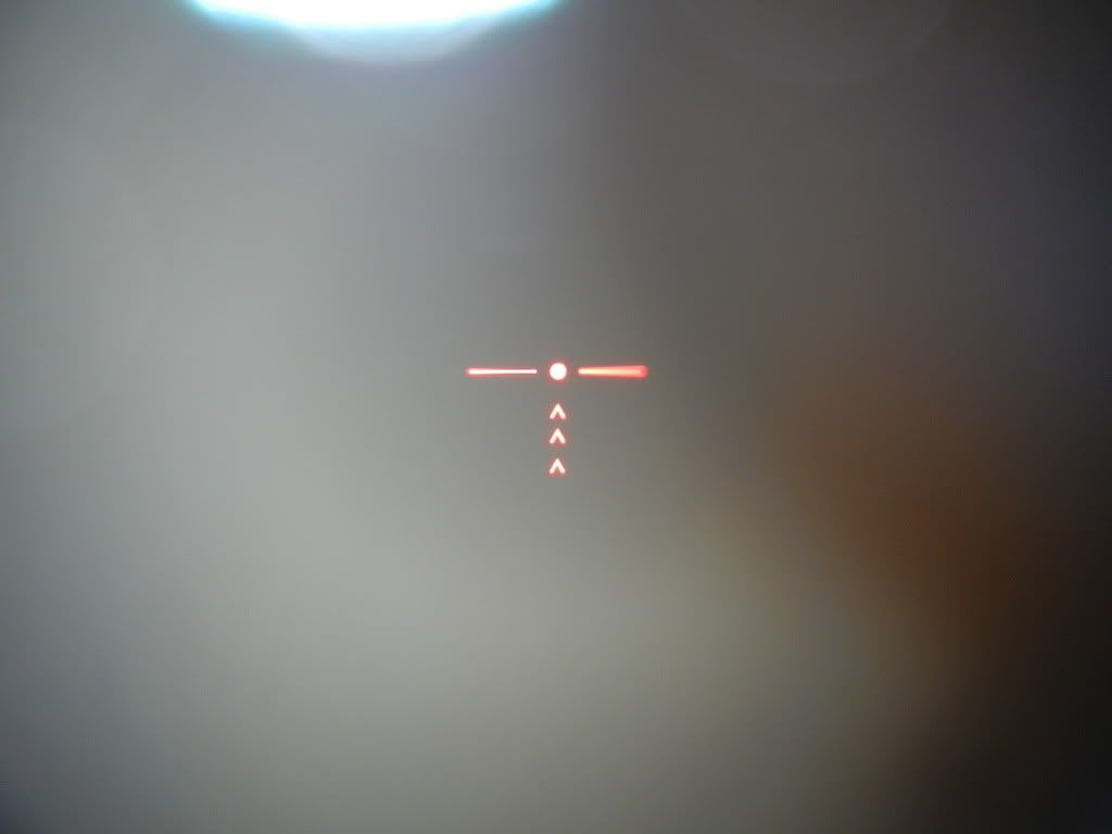

The reticle is money. It's simple and easy to use, without being busy or crowded. The dot is 2 MOA at 4x. The chevrons are very well designed and I have found that a point is noticably more effective than a cross in precision shooting. Thus I really like the very fine chevrons over cross hairs in other scopes. I read where the chevrons are spaced for 300, 400, 500 at 2900fps. I ran the ballistics and found that from my 20" barrel and 3130fps match loads, the chevrons line up very effectively as 400, 500 and 610yds. This gives me a center dot at 230yds, which is a very easy range to work with in a 3gun rifle. I sat at the 425yrd range this morning at Pueblo and went back and forth on every steel and made short work of even the difficult targets. So the burning question every one always asks... is it day light bright? Yep. Daylight practical bright in the brightest sunlight and against light colored backgrounds. Here's the kicker. Even the very fine chevron lines are day light bright and there is no blossoming or halo effect around the reticle or reflected inside the tube. It's not as bright as an aimpoint or a Short dot, but its as bright as a Z6i. It's brighter than an SWFA SS 1-4x HD, US Optics SN4, Vortex PST, Burris XTR and Tac 30. The chevron lines are some thing like .25-.5 MOA and even they are brighter than any of the brightest portions of any of the etched glass competitors. This forces me to call bullshit on any scope manufacturer who claims to have the brightest reticle possible and yet is still not truly day light bright. I've got about 3 hours on the battery with no discernable reduction in intensity. I'll update when the battery starts to fade with an estimate of time. There will be those who prefer a FFP reticle or one with better ranging. Some will say they want windage markings. Some one will want the dot illuminated and the lines not. All personal preferences for which there are other options. I like this reticle, because it gives me exactly what I need and nothing extra. It's bright and fast for close stuff and very precise for the far stuff. Sorry for the poor reticle photo quality. Apparently photography is an aquired skill.
