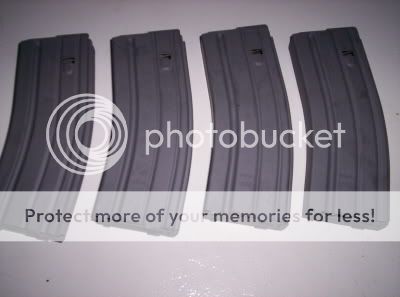

    I was blessed Saturday to pick up 4 used 30 rnd magazines from a member here.
    I tend to prefer USGI/USGI-similar mags but don't have usually have the money to buy any and I've always been put off by the cost of new ones (yeah, I'm cheap and poor).
    The mags I got today have the green MAGPUL followers and these and the springs seems to be in pretty good shape. I have some new green MAGPUL followers and springs to replace them if I find issues with them after trying them @ the range.

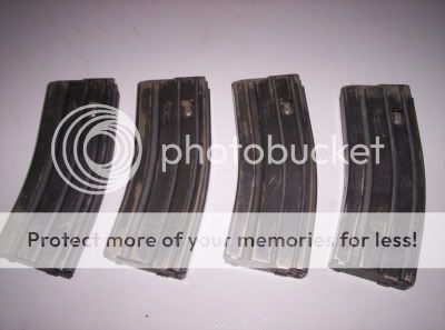

    But, with all used USGI mag's, they weren't pretty.
    While they were actually very clean, I still wiped them down with a solvent which removes all residual oils and dirt as well as softens up the existing coating helping to absorb new coating.
    A quick spray of Perma-Slik G (considered to be the proper product to use to get to OEM specs) and 6 hours of curing and I have what appear to be NEW USGI mags.
    (the smudge marks are from the oils on my hand when I retrieved them from their drying wires.)
    Saturday was a very good day.

    Oh man, those came out great Thomas.
    Where did you get the coating for those? Is it something that had to be cooked afterward or is air dry sufficient?

    WOW, what a difference.
    Colo Spr
    22,069
    The coating product is called Perma-Slik G and is officially tagged as a lubricant even though is comes out/applies like a paint.
    [ETA: Be sure to shake the can very well before using - just like you would with a spray paint. Then, when you're done be sure to invert the can and spray to clear the nozzle for the next use.]
    The pics really don't even do justice the the mag's - they really do look brand spankin new in person.
    The "solvent" I used was pretty basic stuff - "Goof Off" which can be found @ any Wal-Mart. It's not as nasty as a lot of solvents are but does the job of removing oils, etc. very well. When I used it I noticed that it softened the original coating enough that steel wooling the mag wasn't necessary.
    http://www.neelyindustries.com/p-270...rosol-can.aspx
    It runs about $19/can which can easily do 20+ magazines. But it is a HAZMAT item so hazmat fees are applied for shipping. The best thing would be to find others who live near you and do a bulk buy of it to reduce the individual costs for shipping/hazmat.
    No baking is necessary for the curing. Although I've heard of folks who disassemble their mags and bake the coating to get a harder cure. I actually tried this once and can't tell the difference is the wear of t he finished products, so I quit going to that effort. According to the can, after 30 minutes the item is ready for "moderate use" with a full cure occuring after 6 hours. Easy enough! It goes on like a spray paint and coats quickly without having to apply a heavy coat. I always use thin wire in one of the holes on the side to hang them for the painting and then leave them hanging free to cure.
