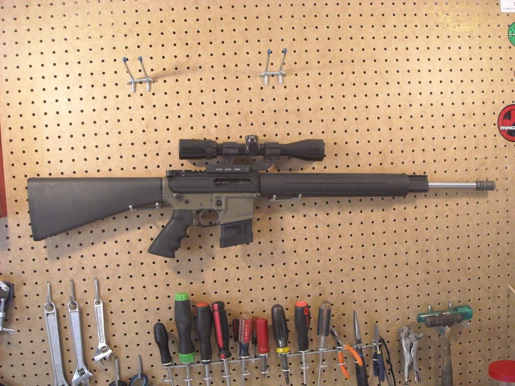

    I am into a reloading mode right now....have about 3K pieces of brass to run thru a single stage press. It got me thinking about chambers and what works and what does "OK" Recently I have built two complete guns for people and both have been Wylde chambers. The first is a coyote/Varmiter for a friend. He did not know much about BPAG's (black plastic Army guns) so I gave him the run down on the important parts and he wanted a reliable accurate gun. I started with a AR Stoner barrel 20" A DPMS Slick side upper (if it wont chamber....you really dont want to fire it) A Rock river bolt, and Model one sales free float tube, basic gas block and tube. Super simple upper with a fantastic Barrel for the money. The lower is a Rock River, with Palmetto State LPK. Palmetto is my goto place for lower Parts kits and Stocks, excellent quality, for basic LPKs. The Fire control group is standard mill spec, I usually do a basic trigger job, polish pins, internal surfaces and the face of the hammer, I dont touch the sear or disconnector, as these are easy to go to far. I cut about a 1/8" off of one side of the trigger spring to lessen the trigger pull a touch. I back that all up with standard A2 stock and buffer, and spring. The fit and finish of the Palmetto LPK is fantastic. That all topped off with a Rock River Canta. Scope mount. The customer supplied the Scope, not my choice but a nice 4-14 does well. I like the 40Gr Vmaxs and this 1-8 tube works really well with them, yielding 1/4" groups no problem.
    All this really needs to be a outstanding build is a better fire controll group, a Rock River two stage for $85 for be a first choice. Totall build is $750.00 for a solid varmiter that shoots.
