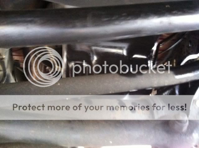

    Here's some pics of the oil splash. I had grease monkey do an oil change last Wednesday and didn't drive it Thursday. Friday I drove up to Greely and noticed oil everywhere. I know grease monkey but I get my oil changed once a month from all my driving and I don't want the oil just chillin in my garage. I do all other maintainance. Anyway I thought they overfilled it but there's oil in front of the crankcase vent tube so kinda ruled that out. Also, I thought the gear case/housing or maybe the front crank seal but there's no oil on the front of the block. It seem to be coming out the driver side of the block. Thought maybe tappet cover gasket but I can't find that so maybe the CR blocks don't have one?? I have been looking for a reason to get a new truck, maybe this is it.
