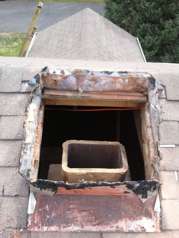

    Harveys blue can of roofing tar from Home Depot is what you want. I'd go an inch or two onto your artwork of masonry...don't cover it up. Then I'd just go over your old flashing and probably 4 inches onto your shingles all the way around. That should get you until the next time you put on a new roof.

    Cool, thanks!

    I know the feeling, however I paid someone to repair mine.

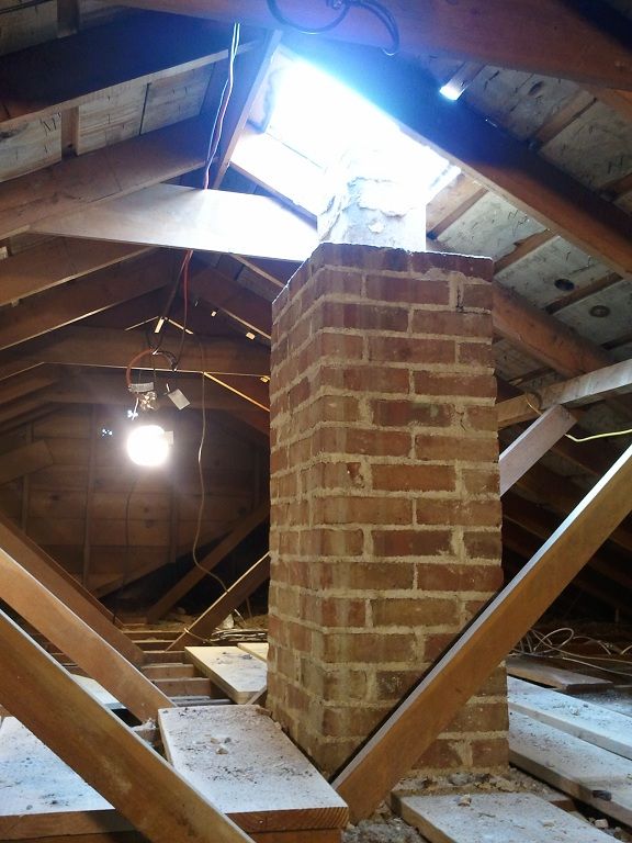

    Looks good bud.

    Hey Jeff, looks good from my house
    Now you know why hod carriers have legs like tree trunks. Must have sucked being on a roof in this heat.
    Have a , you sure earned it!

    Looks like it might be a hate crime.
    Looks like a nice job. I won't mention the flashing. I'm sure you got the hint from the others.

    I wouldn't worry about leaks. You gotta have rain for that.
    Anyway...looks good to me. Not sure I could do that.
