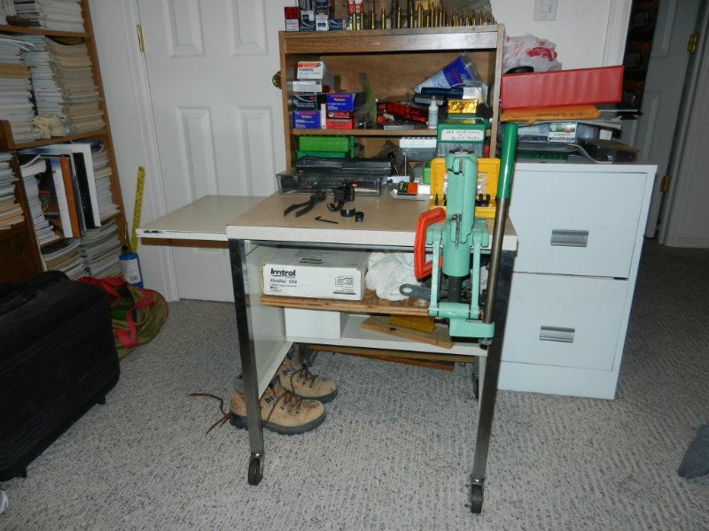

    Nice setups. Here's mine--got it free from work--
    Steve

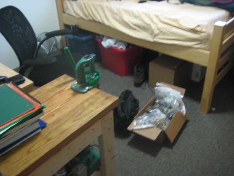

    Built both of these at a friends shop in NE he has all the tools fellow reloader and shooter, makes it easy and cheap took couple of hours to put it together and the night to stain and shellac the top.
    i needed a small reloading table portable enough to move back and forth from Colorado to Nebraska while in school and fit into my small apartment room i primarily use it to size rifle brass i have processed 5000 plus cases on this little guy. made it out of scrap 2x6 planned the sides and biscuit them together to make the top sanded down the top till smooth stained than shellac the top had to buy about 30-50 dollars in materials for the legs and miscellaneous.
    just recently helped out a friend with building another table not portable but enough to mount a progressive and rock chucker picture is not put together will have to post up the finished look. this is just the top after a mild staining about to shellac it. its all finished just need to snap a picture once i see him again. used Craig screws on it so you don't see many holes. this one costed right around 50.00 dollars its 46" X 26" wide about 32" high with bottom self

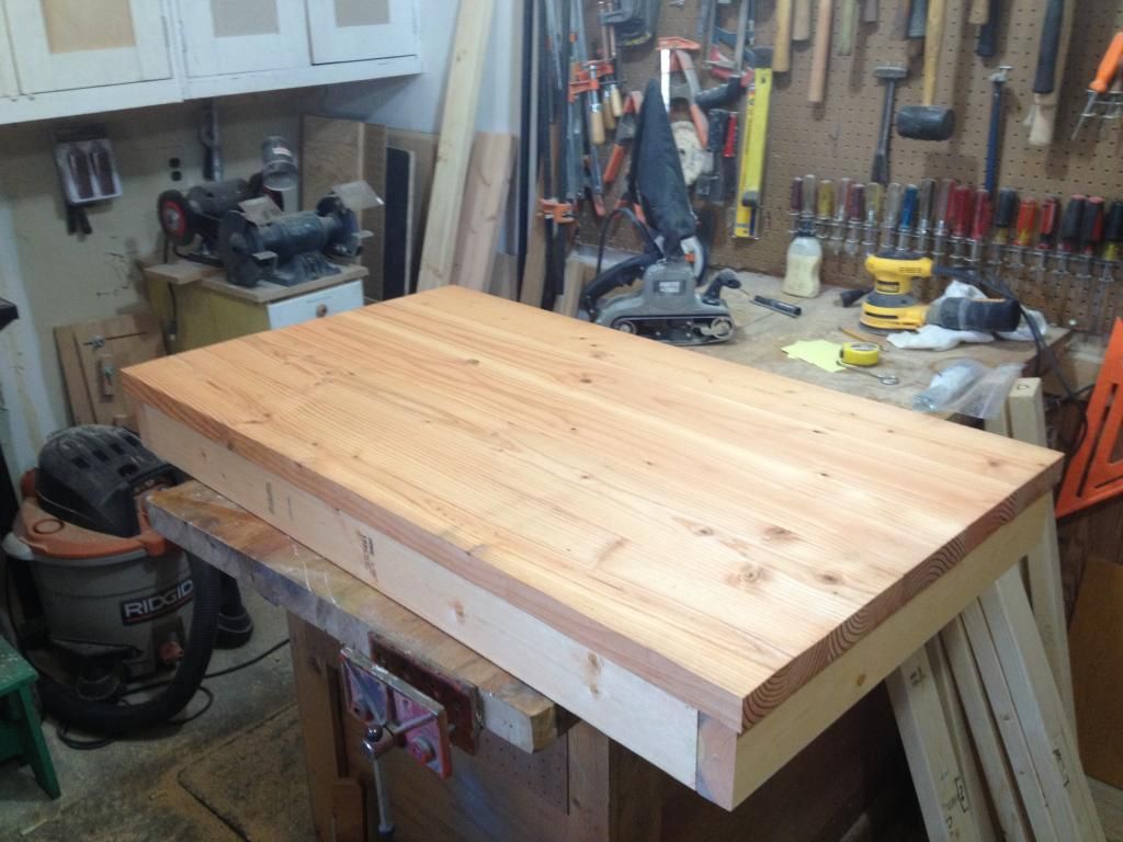

    Quote Originally Posted by rbeau30 View Post
    Well, I do not have a whole lot of room to put a bench, plus I rent, so I don't want to drill some holes in the workbench in my garage.
    I found several examples of what I did, I just thought perhaps the info here might help someone out.
    I got a Workmate 225 for $49.99 from homedepot.com.
    I used 3/8" bolts/nuts/washers throughout the project, along with 2" wood screws.
    I also got that really crappy (warped as heck) wood board 25" wide by 1" thick by 6 foot long. It is the stuff where they glue a bunch of 1x4x6 ft together side by side to get a real wide piece of lumber. Not one of these were straight.
    I doubled up the table top with the board to create a thick top to mount my press onto. The table top boards were so warped I had to put some gorilla glue and bolt them down at each board to get the sandwich to be real straight.
    The sides were screwed from the bottom and from the sides to get a solid/straight box.
    Looks like it is going to work for my uses, however the collapsing function does not work well as the top is very heavy now.
    Now that's a compact bench. VERY nice and portable too. I like it!
