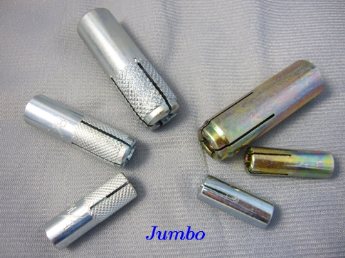

    I tried finding an example of what I used and got stuck, but I can't find anything similar to it online. It was a smooth cylinder, tapped on top about 1/4" down there was a plug. The bottom was cut into 4 "leafs" that would expand as the plug was pushed down into them.
    Sounds like maybe a female anchor?...

    Mason bits and a hammer drill makes drilling concrete so much easier.....also the set tool for the RedHeads.....
    The first anchor may be useable, you need to drive the wedge into place before attempting to install the bolt. Try using a rod or smaller bolt as a punch and hammer the wedge into place then try the bolt again.

    Thats kind of what my plan was if I couldn't get my pin puller to work. I rigged up a 15" piece of 3/8"-16 threaded rod, put about a 5" piece of 2" diameter aluminum on it (already had the hold drilled in it), and two nuts with fender washers on the top side. Really hoping a few hard whacks and it will pop out, but I have the carbide drill bits at home if necessary.
    It looks exactly like the one in the bottom right, smooth sided, was about 2" long and 1/2" in diameter. Thats what the guy said I needed. Well the first guy said I needed was 4x Tapcon anchors. He handed me some 1.5" long, 1/4" diameter screws and said thats all you need, will be more than enough to hold down anything in concrete. I explained that it was a 500lb safe and he said thats good enough. Luckily, my Fiancee called me at that time and he walked off so I could set the screws down lol.
    I was pounding the anchor above (see pic) very hard into the concrete with a punch and my giant hammer. Even after 20-25 very hard whacks, when I would try to put the bolt in, it would thread a tiny bit and then the anchor would slowly pull up. I should have just put the anchors back when I asked the guy what bolt size it used and he said '3/8"'. I said, yea thats good and all but whats the pitch? He said, that doesn't matter, just a 3/8" bolt. Looking at it, I was able to tell it was a coarse thread pitch, but the packaging didn't say one way or the other.
