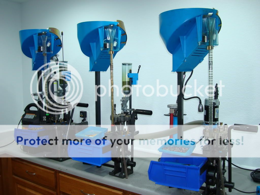

    Yeah but with these tools, I can do anything, faster. Much faster.
    Every time I see pictures of your reloading stuff I keep looking to see if any of those little Chinese kids can be seen. Haven't seen one yet. You must have those kids well trained to stay out of photos. At least I assume you run these things with sweat shop labor.
