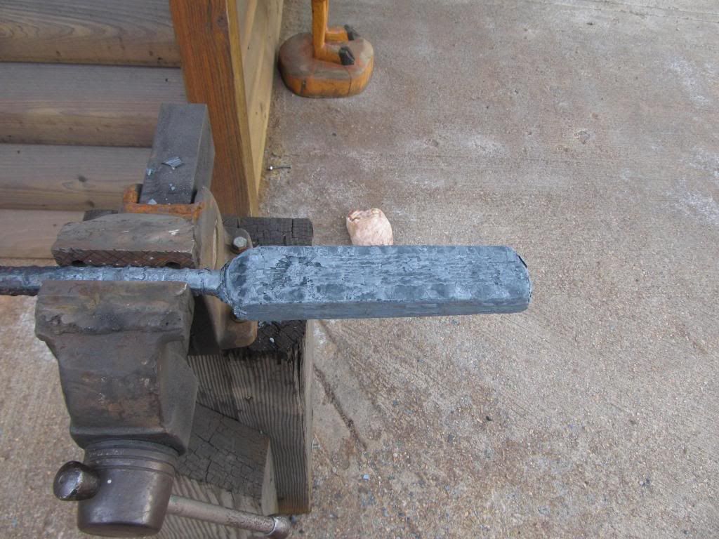

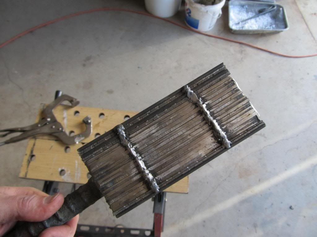

I started out with 11 pieces of 1080 0.125"X1.5"X6" and 22 15N20 0.65"X1.5"X6". The 15N20 doesn't compress as much as the 1080 and this will give me a bright pattern. I weld them up, attach a handle and put it in the forge.

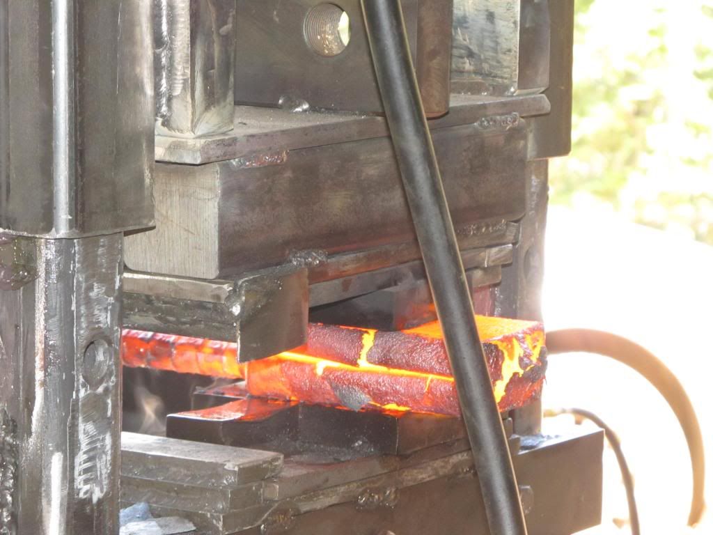

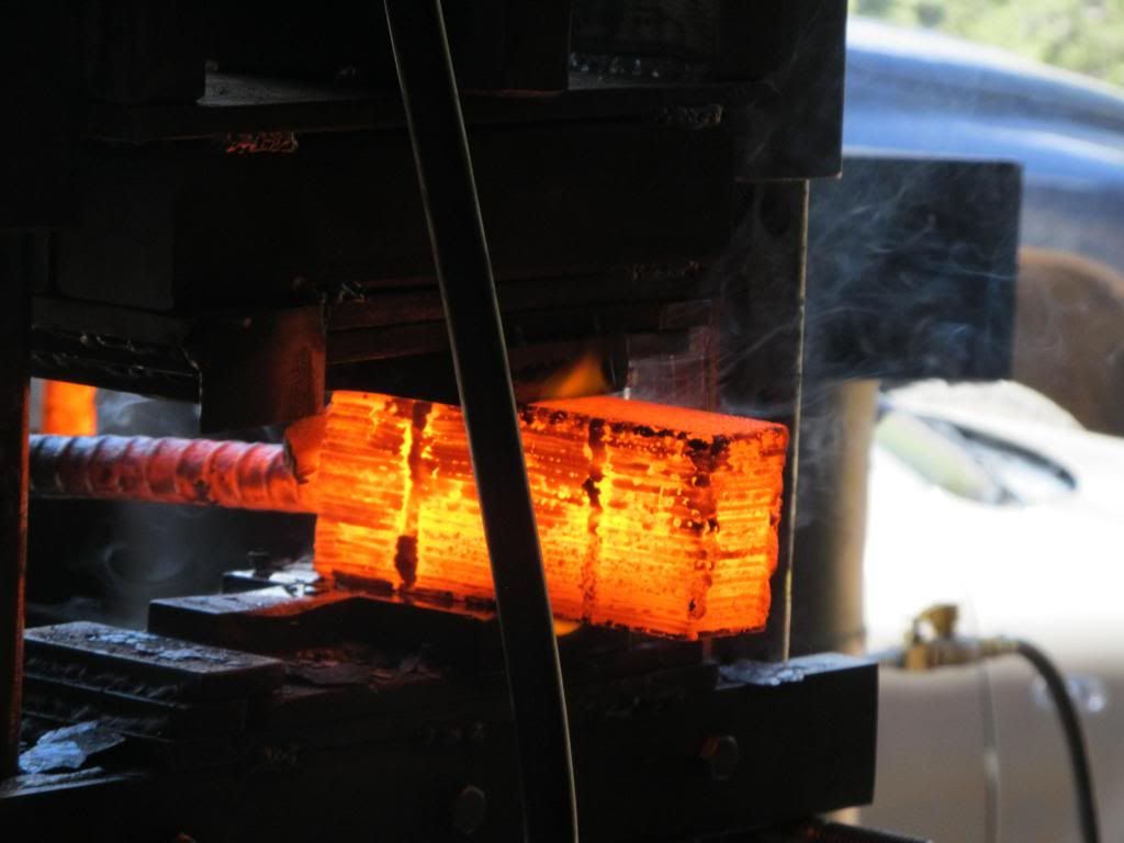

As the billet is coming up the temp I sprinkle flux all over it, when the billet is up to 2200-2300F I put it in the press to forge weld all the separate. layers into on steel block.

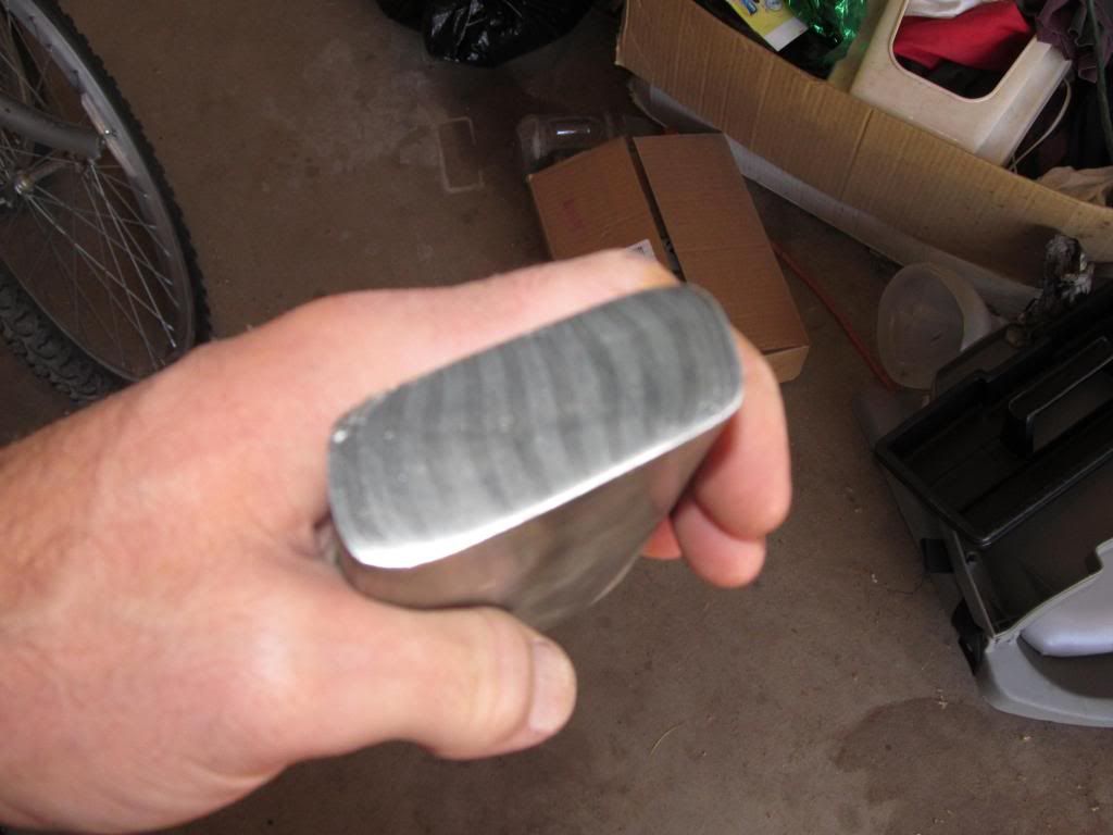

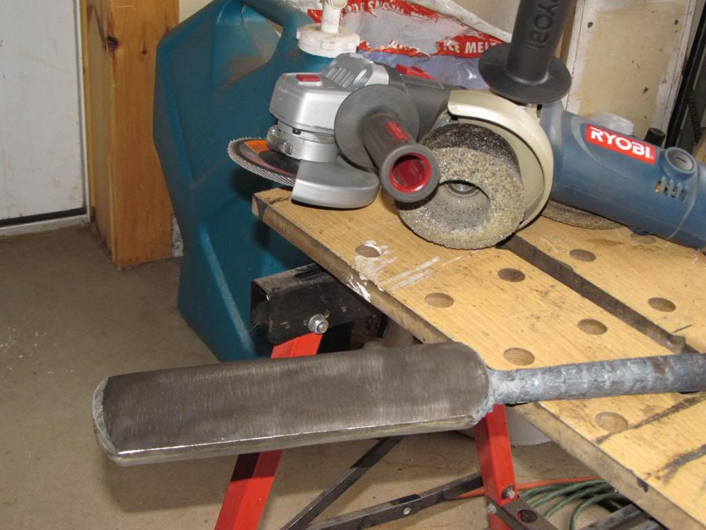

I will draw the billet out to get a piece about 1" thick, then let it cool. Then you grind off the scale cut it into 2-4 pieces stack it then it's back into the forge.
after grinding off the scale.

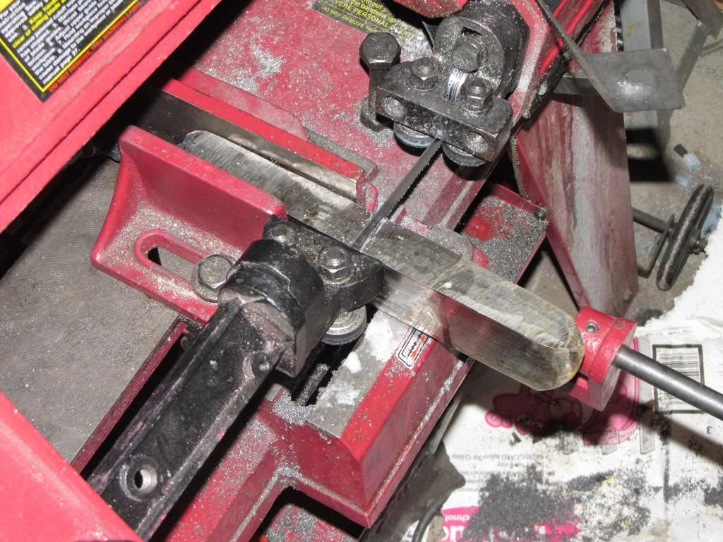

cut in half.
then you can etch the end and see what you have this is after the first forging.

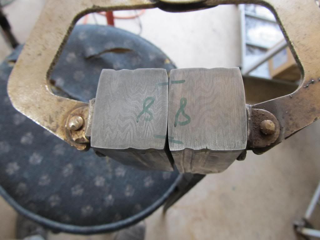

this is the second forge welding step, you can see the flux flaking off.

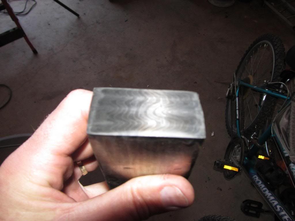

Then you get to let it cool, grind, cut, etch to see what you have.
Then do it all over again.
This is at 8 layers, after I forge weld this one I'll have 16 then just one more to get 32 total layers. If I was going to do this in one pressing I would have to start with a billet that was 48" wide.

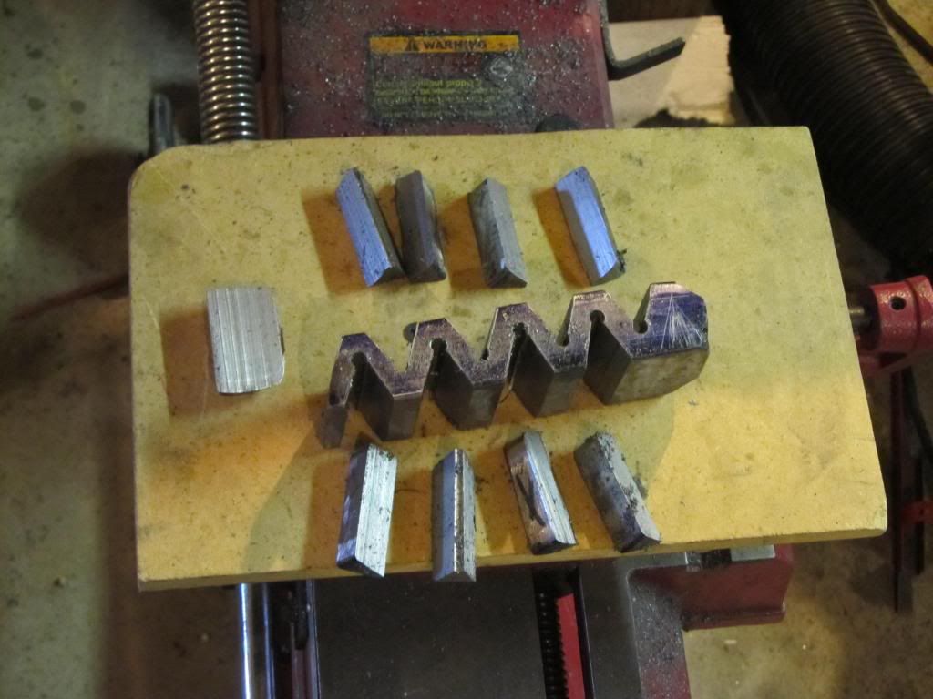

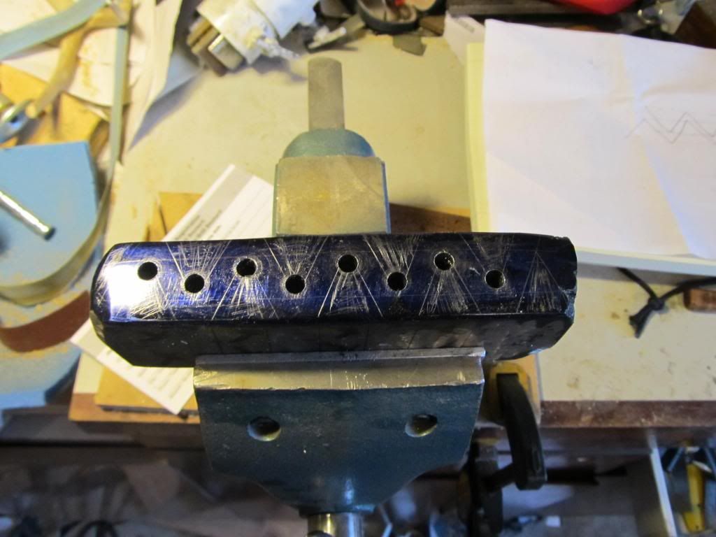

When it's all done and annealed I grind off the scale and then I have to get the pattern on the sides instead of the ends where it is at now. There are a lot of way to do that but here I'm doing an accordion cut. First I drill the hole that will be the bottom of the accordion so that it is rounded and will flatten out without tearing. Then I'm going to cut out the triangles that are scratched out on the billet
that leaves me with an accordion shaped billet that is about 3/8" thick the pattern is on the ends of the triangles that I cut out. When I forge this flat it will bring the pattern the the face of the blade blank. I use a 1/2" round bar to slowly flatten the billet out if you are not careful the bottoms will tear because there is a lot of stress placed there.

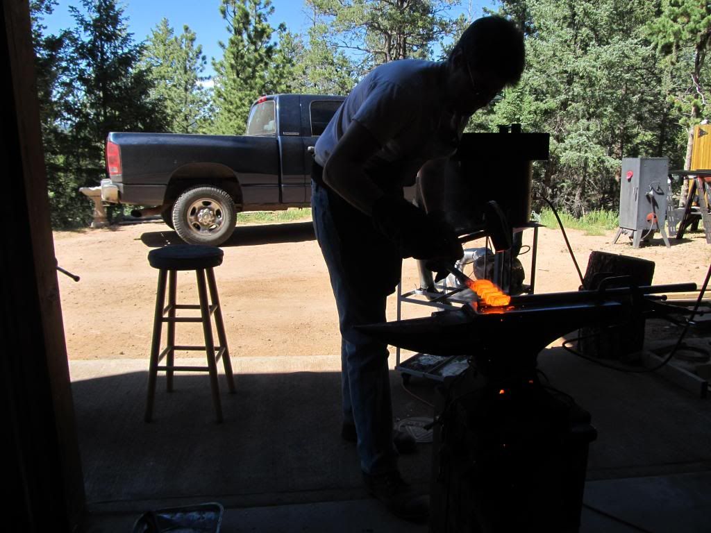

then I forge that into a knife shape that I want.
