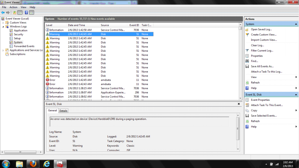

    My guess would be a failing HDD. If you can get into it, run "eventvwr", expand Windows Logs, and check the System log for disk or controller errors.
    I've seen diagnostic apps say a drive is fine, but you can tell by the unusually high activity that isn't the case. The manufacturers of the drives usually will have a utility to thoroughly test the drive for excessive bad blocks.

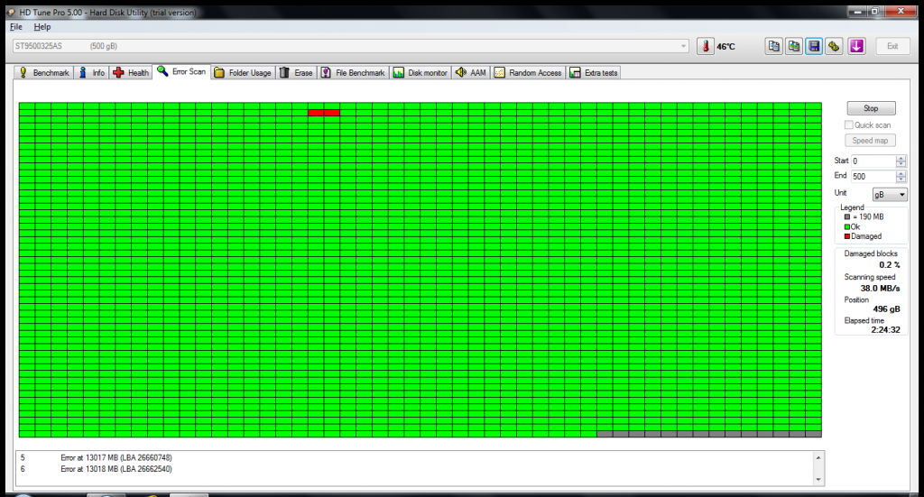

    Well, looks like the hard drive doesn't have "much" damage...or am I wrong? Trying the other suggestions now. You guys rock!
    Damn. Looks like you may be right.
    No, that looks perfectly fine to me. I have a hdd with more damaged sectors on it than that, and it operates perfectly fine. The "eventvwr" log does show warnings, at this point I agree with zundfolge, backup your data and reformat hdd, reinstall windows and see if it continues to misbehave.

    SATA controller errors and disk errors. I've seen that a "few" times (I manage over 22,000 Windows systems for a living). Sorry about that. I'd hate to see someone go through the trouble of a system restore on a bad HDD to only find that the problem didn't go away.
