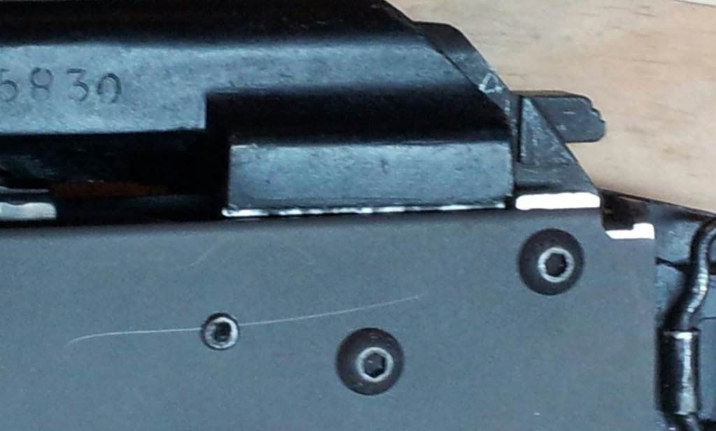

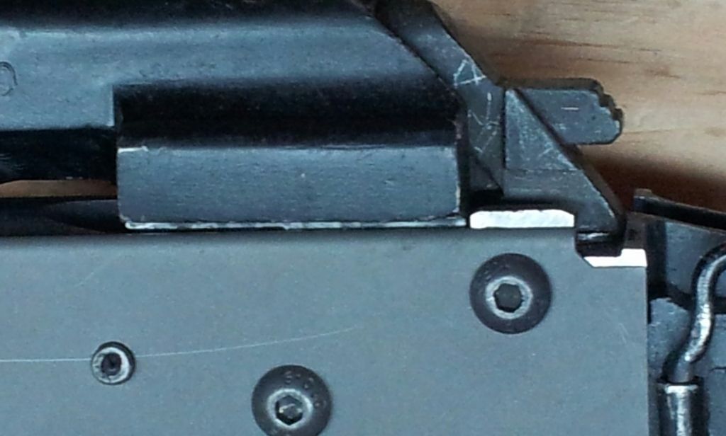

    Gong Shooter spongejosh's Avatar
    Jan 2012
    Centennial, CO
    308
    Here are the best pics I could get of it with my phone. This is the side that's hanging and these pictures are of it in the stuck state. Barely pushing down on the BCG at this point with release it and sent the bolt home.
    Oct 2007
    Windsor
    1,903
    Its possible that the receiver cut out for the bolt carrier is a little large. The proper fix would be to weld up the top rails and then re-profile and fit again. I would use a tig welder.
    You could be perfectly fine though. Sometimes when you pull the charging handle you will pull up a little bit was well and can cause that. During firing the bolt carrier could never have a problem.
    I say run a couple of hundred rounds through it and then inspect the top rails of the receiver and see if the bolt carrier is hammering at the top rail. If it is I would weld it up, and re shape rails.
