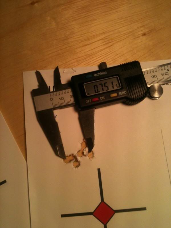

    After spending the last 5 months collecting equipment, powders, primers, bullets...I finally finished my first reloads yesterday, not without learning mistakes along the way.
    My first test is for an RRA Varmint A4 20" 1:8.
    69 SMK HPBT over .5 grain increments (23.5 - 25) of Varget. (I decided to add two more rounds to each row after i took this pic. Figured shooting groups of 7 was better than 5)
    After I loaded these up I headed to the range. I was pretty damn nervous firing the first round. Best group was with 24 grains of Varget. I'm thinking I should probably play around with .2 increment weights around the 24 mark and/or practice shooting more. Feels good to be reloading!

    Nice. I second .2 increments. You could be missing a whole lot of performance in between the .5 mark. Plus saving powder here and there adds up.

    I second what Jim said about .2 increments.

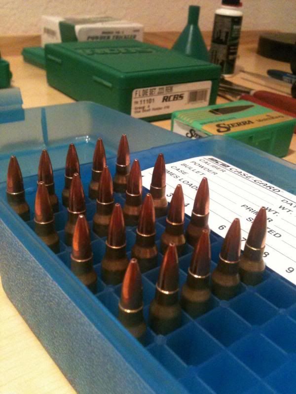

    The first ever loaded rounds from my own hand:
    .243 Load Data
    Primer: Remington #9_1/2 large rifle
    Powder: IMR 7828
    Brass: Hornady New Brass
    Bullet: Hornady 105gr A-Max
    COAL: 2.75"
    These are the first part of loading for the bolt gun I'm going to give my father in law. He likes shooting big magnum calibers (his standard go-to is a 300 RUM!), so I thought I'd give Hume something a little less tame, but with the reach out there that he likes for coyotes and SD Speed Goats and the occasional white tail.
    .243 Load Data
    Powder: IMR 7828
    COAL: 2.75"
    now I've started the load development. Started at 40.6 and went in 0.2 gr increments up to 42.0 gr. max load for this powder is 44.0, so I'm not in any danger I don't think of going up to 42.0. Thoughts?

    Generally when I start load development with rifle, I'll do 1% jumps. In this case .3 or .4 grain increments. You might come back and fine tune, but it should give you an indication of what's going on. As I approach max, I might do smaller increments.
    Looking at Sierra data, and cross referencing with yours, I might go up to 43.5 grains. You generally won't find the max load to be the most accurate anyway...
    Let us know how they turn out.
    yeah, I'm not really wanting to go up to max data. .243 is a barrel burner anyways, so by using a slow-ish burning powder and trying to keep the pressures down I'm hoping to keep it as manageable as possible for the old man.

    Usually find accurate loads on the low end anyway. Good luck, be safe, have fun!
