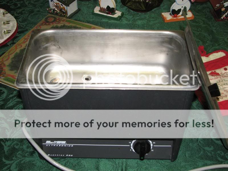

    I have the large unit from HF, reckon it holds maybe a quart? It has a heating element, so it heats the solution. I use stoddard solvent in it out of my parts washer for nasty gun parts. It'll make short work out of cosmoline stuck in all the nooks and crannies of milsurp rifle parts. Just used it last night, as a matter of fact.....

    I have an old dental one that works great. I does great things on Carburetors and those old SKS bolts and actions did not stand a chance.
